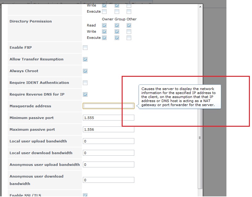

I have the same prob dynamic ip and the mask only accepts an ipv4 the issue is that we have to put our dyndns hostname in but it only accepts ipv4 what looks strange to me because the infobox tells me that i could give a DNS host into it screenshot maybe a bug ?

Yep. Sounds like you have the same problem. :( I don't think it's a bug, more a limitation of the current software. Maybe put in a request for the feature?
