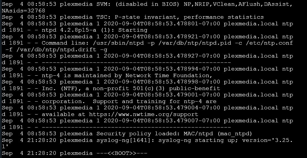

I looked at the output of the /var/log/messages file from the last two crashes, and the last line both times before the restart says "<system name> Security policy loaded: MAC/ntpd (mac_ntpd)". I'm attaching screenshots.
I've done some research and found some articles (such as the one I'm noting below) about some issues with Ryzen processors. Is this still an issue? Looking for any ideas here. Thanks in advance!

Hi, pschatz100. Thanks for the warm welcome. To clarify, no, the problems didn't start when I built a new system. I had been running FreeNAS for a while on this box, since the release of version 11.2, I think. It was rock solid for about a year or so, but at some point, it just started freezing on a regular basis. I reinstalled the OS to rule out anything corrupted in there, and then did a fresh install of the 12.0 beta. I did try reseating cables and all that (first thing I did), and even replaced a few that looked like they were "aging".
I found my mobo is specifically an ASUS ROG STRIX B450-E. The BIOS is fully up to date, and yes, the Glotrends adapter was always working fine, and no problems have been reported in FreeNAS with the pool. I did try booting from a couple of different Linux Live distros (Kubuntu, CentOS, for example), and not all of the drives were detected, whereas Windows (server and client) picked them all up in setup. I thought that was interesting, since, as I said earlier, this card is "supposed" to have Linux support (and yes, I do understand that FreeBSD is a different beast than Linux). So, a new card may be next on my upgrade list for this thing.
Took me a while, but I did find the C-state setting in the mobo's BIOS. The only options are "Auto", "Enabled", and "Disabled" - no other configurations are available, so I've completely disabled that setting. I'll see what kind of effect that has over the next few days.
Thanks for the suggestion! I'll keep you posted.
