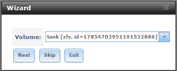

Trying to create a new Volume with the Volume Manager from the GUI (actually using the initial startup wizard) and I'm unable to switch it from 'tank' to something else. I received a quickstart manual with the purchase and when I try to use the initial wizard (or the wizard on the top bar of the GUI) I get the message "ZFS WARNING: Unable to attach to ada0." as readout on the screen connected to the FreeNAS Mini.
Any thoughts? Suggestions? Is this warning bad? Why can't I access the volume manager?

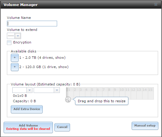

Volume Manager has ...

Yes, you can create your volume via volume manager. The wizard is optional - many users skip it and configure their server themselves.

Still getting error though... what is the best way to just wipe current volumes out so I can create new ones? (Is that called the pool?) (Or maybe I don't want to?)

iXsystems called me back and told me that the issue was possible that they had not deleted the zpool that was creating through testing and initial burn-in.
If anyone wants to follow the steps we did, please read below.
As a DISCLAIMER this solution may not work for your FreeNAS Mini.
Directions for correcting this for anyone else with similar issue:
  1. Go to the GUI by using the IP Address assigned to your NAS (either through DHCP or Manually assigned/static
  2. Then Storage >> Volumes >> Import Volume
    1. Currently you will see "Step 1 of 2" and "Encrypted ZFS volume?" .. You will want to select the radio button "No: Skip to import" and then click "OK" on the bottom left
    2. Currently you will see "Step 2 of 2" and "Volume" with a drop-down menu that should say something like "tank [zfs, id=<insertstringofnumbershere>]" and nothing else .. Make sure the aforementioned volume is selected and then click "OK" on the bottom left
    3. This will import the volume
  3. Now select the volume (by clicking on the name of the volume at the top left of the pane)
    1. Now click "Detach Volume" on the lower left (icon looks like a stack of disks with a red X on the upper right)
    2. Your screen should turn red
    3. Check the box to the right of "Mark the disks as new (destroy data):"
    4. Click "Yes" in the bottom left of the screen
  4. Voilà! Now you can use the Quick Start Guide (June 2015 Edition for FreeNAS 9.3) supplied by iXsystems and get to and through "3. Volume Configuration" correctly
