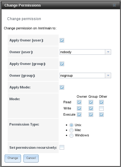

The only issue I had was with the permissions. After re-reading the 9.3 guide 10 sharing section, I set owner to nobody and group to nogroup. After the mount, I was unable to create files in the /mnt/main nfs share. This is confusing since the permissions on /mnt/main are for nobody/nogroup (owner/group) to read, write, and execute and other is set to only read and execute. Also, set permission recursively even though the picture doesn't show it.
The /mnt/main nfs share is also set to Mapall User to nobody and Mapall Group to nogroup. The only way I go this to work was by permitting sudo on both groups nobody and nogroup. I know this is a security issue and would be interested in any guidance offered.

When I set up datasets for sharing via NFS, I set the dataset ownership to the appropriate user/group, and the NFS mapall user and group to match. The obvious thing I do differently from you is not using nobody/nogroup.

I maybe setup wrong. I re-read section 10.2.1 of freenas 9.3 guide and realized that by using the nobody group that I'm actually turning root privileges off. I'm going to set up different groups and test.
