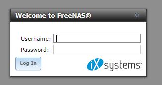

One thing I thought was strange after adding the drives is the available storage has not changed? But I have a healthy volume now. Also I have lost login availability to select the new GUI. Has access to the GUI been deleted in the last update or is there a shell command I need to entry to get the link to GUI when logging in?
The new GUI was disabled in 11.1 because it was broken, due to changes that were missing bits only in 11.2. 11.2 should be out in a few days.
