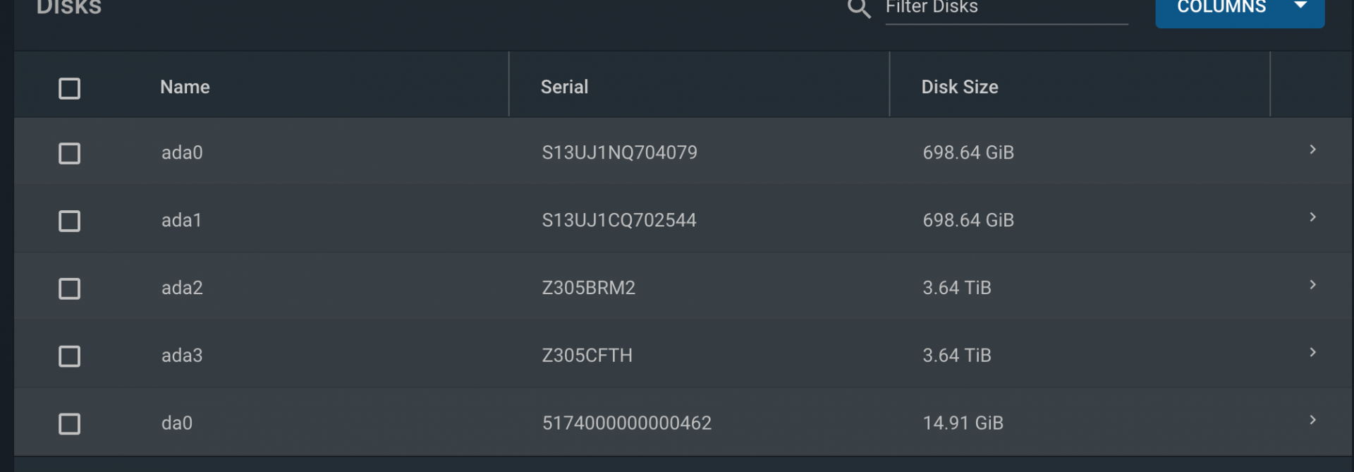

And when finally the GUI went up it shoes both zpools offline. Disks are visible from the Storage menu.
Any idea how to proceed?
I'd like to rescue at least part of my data...

Take a config backup from System | General and install a fresh copy onto the new USB, then restore the config.
Ideally that will be enough to bring your pools back.
If not, go to Storage | pools and import your pools from there.
If you aren't successful after all that, we can discuss some command line stuff to see what can be done.
Don't worry, it looks like your pools will be fine, all your data is likely to be safe.

Thanks @sretalla did as instructed.
After installation the system boots normally but shows no pools.
Restored the config.
Now stuck on boot with a series of messages
efipart_readwrite: rw=1, blk=xxxx size=yyy status=7
and
ZFS: i/o error - all block copies unavailable
Failed to find bootable partition
Failed to start image provided by ZFS (14)onds
I'm assuming the zfs boot partition on the new USB flash drive got corrupted upon config upload (too much coincidence?).
Shall I start from scratch and restore to a backup config from last Oct?
Update: I did an upgrade on the newly-installed-then-damaged USB stick, preserving the db. After the restart the situation is back to normal - all pools are back online, no visible errors.
What should I do to make sure I'm safe?
