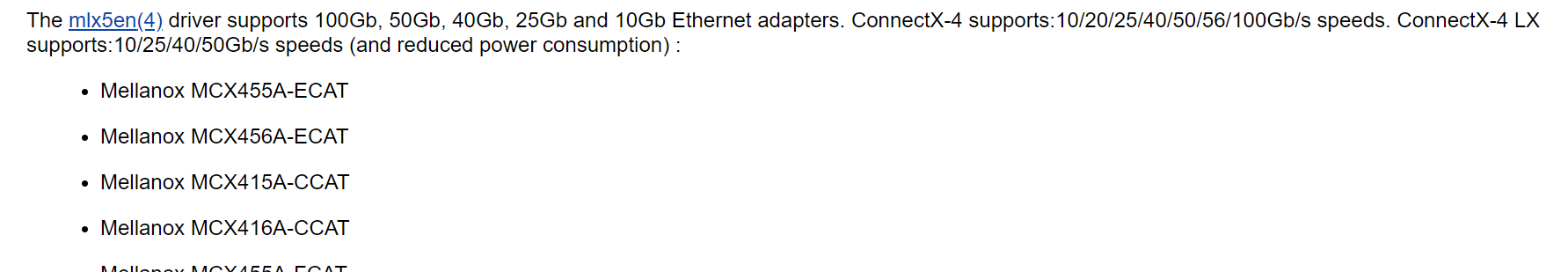

But the model is listed on the hardware supported list, isn't that mean the driver should be already build-in? Sorry, I'm not very familiar with freebsd.
https://www.freebsd.org/releases/11.1R/hardware.html#ethernet
