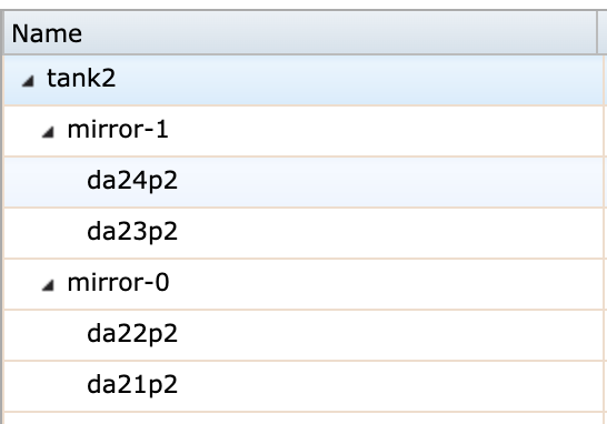

I just wanted to ensure that, how many drives should I need to expanding my pool?
My setup is 4x 12TB disks which separated 2x Mirrored like below.
Should I make another 2x 12TB mirrored vdev and attach that into the pool such as mirror-3.
Thanks
9,700
Yes.
That seems perfectly reasonable.
