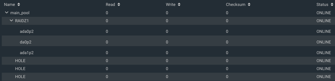

I'm on the latest stable FreeNAS 11.3.
I'm attempting to replace the SLOG and ARC disks on my system and am getting the following error when trying to add either a new SLOG or new ARC. I previously had a SLOG and ARC, but used the GUI to remove both successfully. I get the below error when attempting to add both at once or when trying to add either one individually.
Error: Traceback (most recent call last): File "/usr/local/lib/python3.7/site-packages/tastypie/resources.py", line 219, in wrapper response = callback(request, *args, **kwargs) File "./freenasUI/api/resources.py", line 1421, in dispatch_list request, **kwargs File "/usr/local/lib/python3.7/site-packages/tastypie/resources.py", line 450, in dispatch_list return self.dispatch('list', request, **kwargs) File "./freenasUI/api/utils.py", line 252, in dispatch request_type, request, *args, **kwargs File "/usr/local/lib/python3.7/site-packages/tastypie/resources.py", line 482, in dispatch response = method(request, **kwargs) File "/usr/local/lib/python3.7/site-packages/tastypie/resources.py", line 1384, in post_list updated_bundle = self.obj_create(bundle, **self.remove_api_resource_names(kwargs)) File "/usr/local/lib/python3.7/site-packages/tastypie/resources.py", line 2175, in obj_create return self.save(bundle) File "./freenasUI/api/utils.py", line 493, in save form.save() File "./freenasUI/storage/forms.py", line 282, in save return False File "./freenasUI/storage/forms.py", line 273, in save pool = c.call('pool.update', add.id, {'topology': topology}, job=True) File "/usr/local/lib/python3.7/site-packages/middlewared/client/client.py", line 513, in call return jobobj.result() File "/usr/local/lib/python3.7/site-packages/middlewared/client/client.py", line 276, in result raise ClientException(job['error'], trace={'formatted': job['exception']}) middlewared.client.client.ClientException: 'HOLE'
I also thought it was weird that this same odd "HOLE" thing appears on my only pool's status page. I attached a pic of that. What should I do?

I'm not super familiar with 11.3 but my guess is that the SLOG/L2ARC devices were not properly removed/configured. You can first check plain old zfs with a good ol' zpool status.That'll tell you what zfs thinks the slog/zil format should be. If you see devices listed as log or cache devices it would indicate that removing the devices was not fully successful. If you do not see them then my next place to look would be configs specific to freenas.

Thanks for the response! zpool status looks normal (see below). What sort of FreeNAS-specific configs should I be looking for?

That behavior seems odd to me. It might be that the log/cache devices were removed but not erased and that resulted in the failure to add them back. That doesn't explain why the UI would show "HOLE" but that zpool status would not show any log/cache devices.
If no one else has a great idea for something you may have done wrong or can do to fix it I would suggest you consider filing this as a bug. I've played around with log/cache devices in 11.2 and have not seen "HOLE" appear at any time.

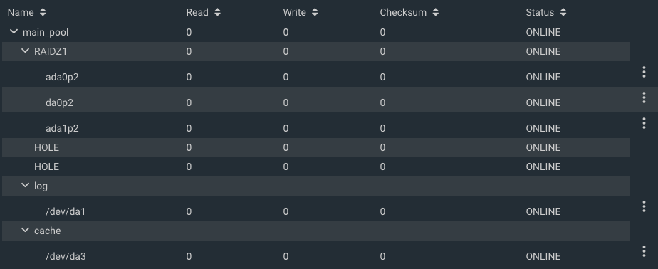

Decided to try adding both from the command line and was successful. See attached for what the GUI now shows. I'm assuming this is a GUI bug in 11.3.
# zpool add main_pool cache /dev/da3
# zpool add main_pool log /dev/da1
I would guess you're right. I would also suggest you not use the CLI for this for permanent configuration. FreeNAS makes use of certain partitions, flags, etc with its drives and if you don't do it just the exact same way unexpected behavior may result. But it is good to confirm that it should work.

Hey @llamb I did some research on this and the short answer is the problem has been fixed. I was running into the same problem right after upgrading to 11.3. Here is the fix https://jira.ixsystems.com/browse/N...ewared.client.client.ClientException: 'HOLE'". The problem is with py-libzfs https://github.com/freenas/py-libzfs and it showing the hole device in the web interface. The real question is how would you get this fix. Because of the way that Freenas is built you can't just change some setting or code to fix this problem. You need a whole new build. At this point there is two options. You can wait for freenas to release a new build part of 11.3 train will fix the problem. OR you can build your own image using this git repo https://github.com/freenas/build/. WARNING this is NOT for beginners as you will need a clean install of FreeBSD version 11 with 100gb of free space and 16gb of ram. Also it will take a while to build mine took over 5 hours but your time may vary depending on CPU. The current master build did fixed the problem and everything is working fine now.
