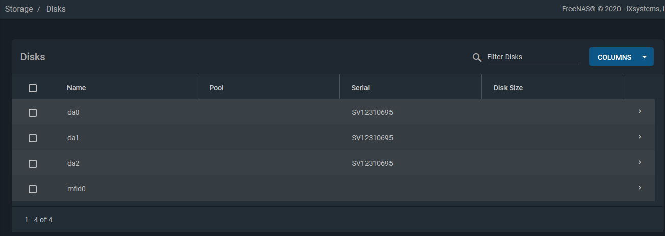

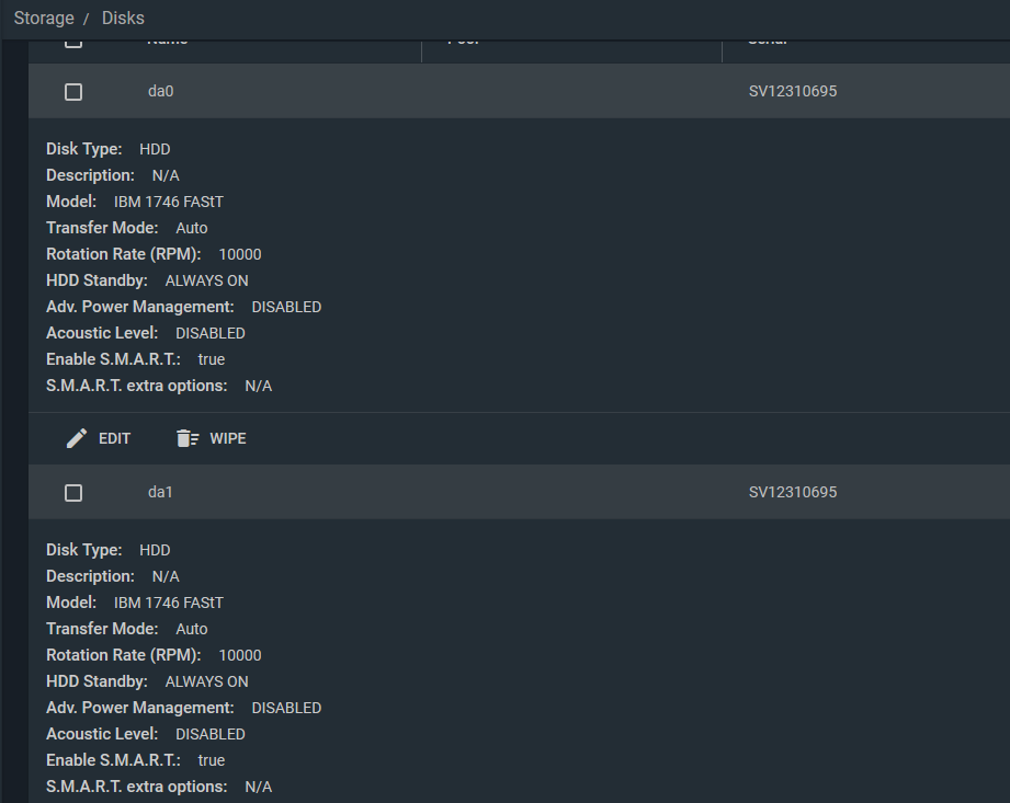

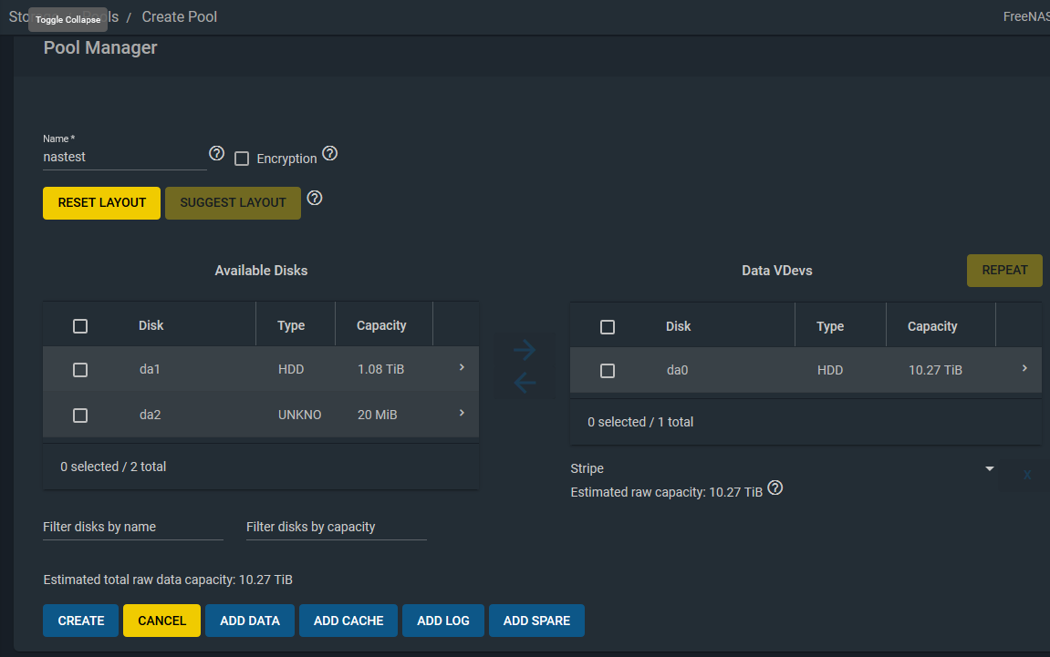

I've been trying to use this freenas setup I installed some time back but keep running into problems each time I get back to it when trying to set up pools. The storage I'm using is IBM external via FC and is seen by FN. I'm including some images to show how far I'm getting.
Did something go wrong when I built the system and need to rebuild or something else? I'm at a loss with this newer (to me) version.
I've been using 9.3 for years without a single issue.
Can anyone give me some leads on what I have to look into to get this system to work.

middlewared.client.client.ClientException: [EFAULT] Failed to wipe disk da0: [EFAULT] Command gpart create -s gpt /dev/da0 failed (code 1):
gpart: Invalid argument

Why are your serial numbers all the same? That won't work.
Apr 26, 2015
320
Hi Chris,
I've no idea, it's not something I've done manually or intentionally.
Is it something I can edit or can view from the cli?

I see there is an edit option for the disks. Should I manually make each serial unique?
Nope, won't let me edit that.

Sorry. Looks like I have replied to the wrong post. I am not sure why, but the serial numbers need to be unique. I had another person on the forum almost two years ago that had a bunch of drives where the serial numbers were zero. That doesn't work either. ZFS don't tolerate it.
You have to figure out why the serial numbers are all the same. It must be something about that IBM external via FC ...
