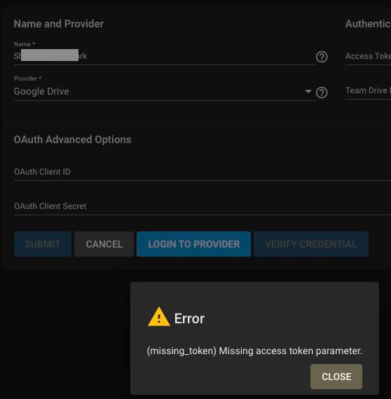

The first stage of authorization started working by itself. I just tried it again and in the step where the "502 Bad Gateway" error appears, the Authorization page loaded, as indicated in the help.

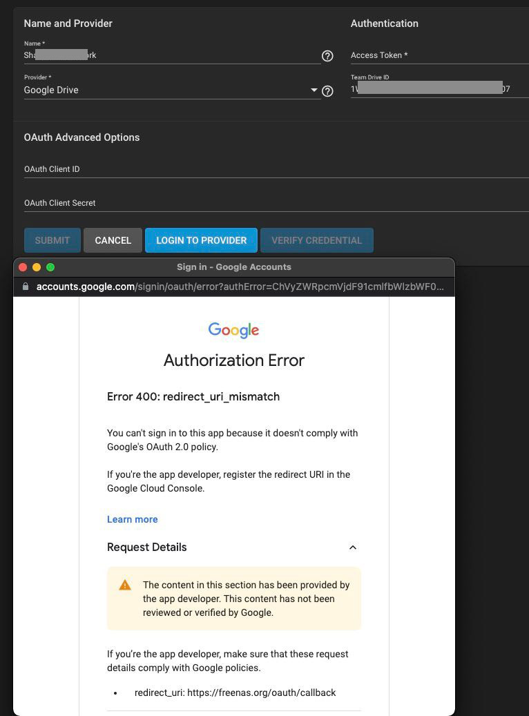

But after I selected a Google account for authentication, at the next step I received the error "(missing_token) missing access token parameter".
I read the forum and realized that apparently you need to fill in the “Team Dilve ID”. Created a test folder on my Google Drive, inserted its ID.
But then I got the "Authorization Error Error 400: redirect_uri_mismatch "- see print screen.
