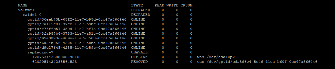

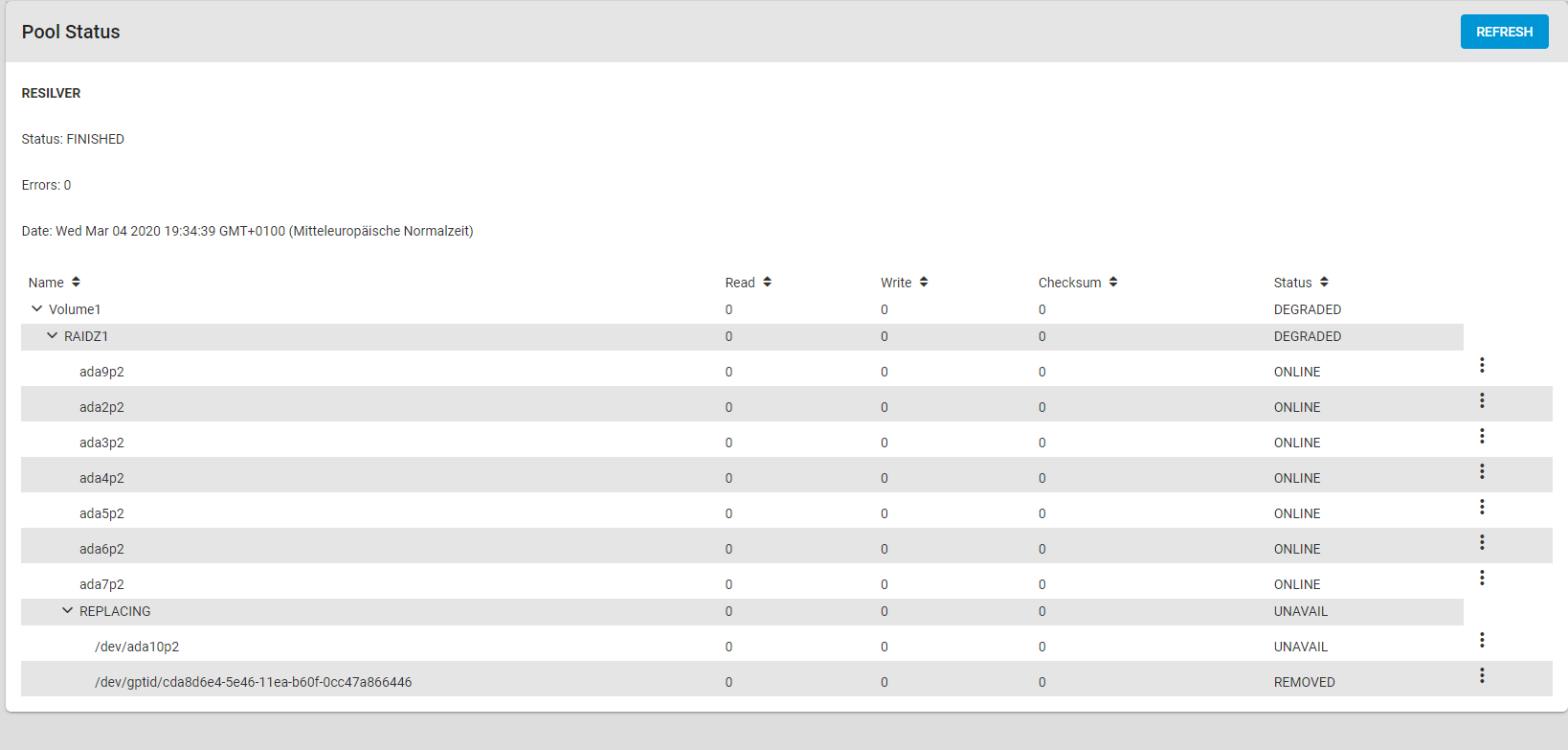

Hello everyone,
few days ago i got the notification from FreeNAS, that my Pool (RaidZ1, with the 8 WD Red HDD's) is degraded.
Consequently i ordered a new HDD, to start the resilvering process. The resilvering started and everything looked fine. But after 12 hours it just stucked and looks like the resilvering process doesn't get on anymore.
I followed the steps in the guideline (Pool is unencrypted):
1. Set failed disk offline
2. Changed the old HDD for the new HDD
3. Chose "Replace" on the Web-UI and selected the new installed disk
4. Waited and hoped for the resilvering to finish successful
Attached you find some screenshots about the current situation.
Any further ideas, what to do next or had already the same problem?

That doesn't look good. Seems your new drive has failed "OFFLINE" while resilvering. Pull it out and test whether it's done a "died after arrival" on you in another box/USB caddy.
Do you have a backup of this zpool? You're in a risky situation right now since it's RAIDZ1. I'd recommend having two disks on hand in future, or better re-creating this as a RAIDZ2.

Do you mean the new "drive" is defective ?
I remember while the resolving is running, I look via IPMI on Server and I see errors.
Do you mean I can repeat the resolving on an other SATA Port

Yes, I think the new drive has died during resilvering. Do you recall what the errors were? If you SSH onto the FreeNAS you can use 'dmesg' to show them again, or 'less /var/log/messages' which gives you datestamps too.
Test the drive in another non-FreeNAS machine, as the partial resilver may have left enough tracks on the new drive to confuse things if you plug it back in again. If it works, I would blank it in the other machine and try again in FreeNAS.

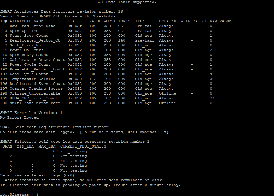

This are the SMART valves ;( from the new drive . Very Bad

CRC errors sometimes come from bad connections or cables. Having that many errors would "offline" the drive most likely.
check cables and connections. also look at the port on the drive, it may have some sort of damage.

OK I have replace the Cabel and now the resilvering automaticly . I hope the problem is fix.
Thank you for your help. I will write when it done.

Ok ! It's done and finish - all drives are Online.
