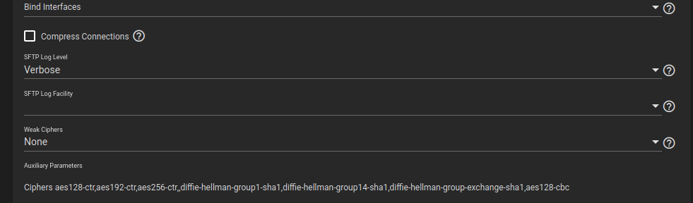

Navigate to Services, edit the SSH service, click on Advanced Options.
In the field Auxiliary Parameters enter: KexAlgorithms +diffie-hellman-group14-sha1
Restart SSH service.
That should fix it.

thanks for the response .. it seems Diffie-hellam-group14-sha1 is there already
although the line doesn't start with "KexAlgorithms"
should i include it ?

Did you put that line in there? Normally this field is empty.
Your Cisco is complaining about the key exchange. So you should put another line like I suggested in there.

Thank you Patrick .. problem Solved
i don't know how the previous line got there... found it there after 12.0 update.
well, i removed it and replaced it with the line you provided. now my cisco backup works.
