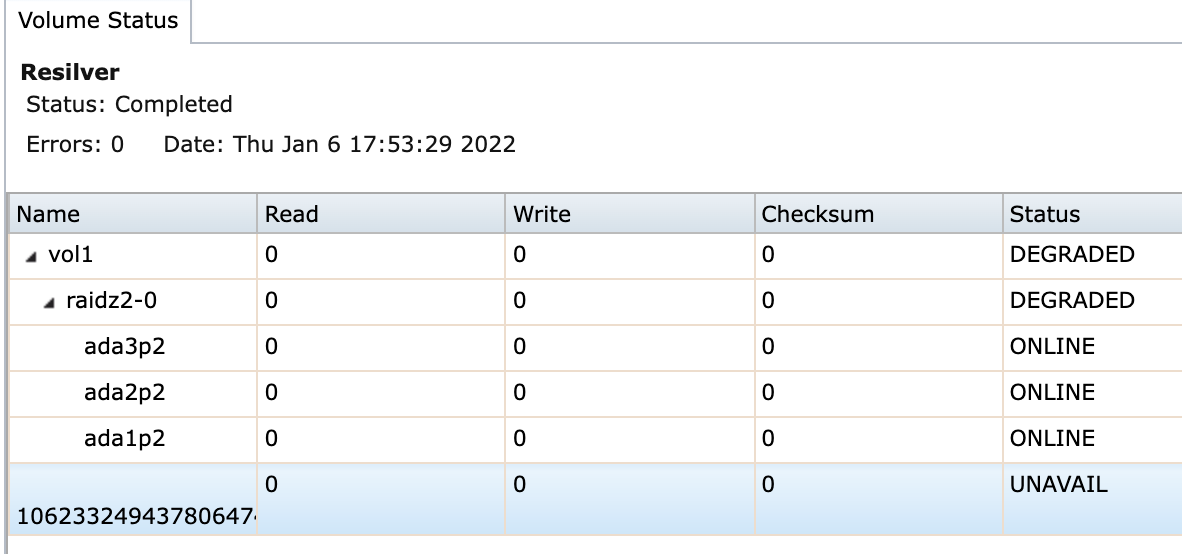

Hi, I think I did things incorrectly, and I'm not sure how to best resolve it. I was replacing a disk in a zpool via gui, and did "replace" and selected the replacement disk which was plugged into an extra slot. When it was done resilvering, I wanted to remove the old drive, and put the "new" drive in the old drive's slot. When I did that, now it can't seem to recognize the disk:

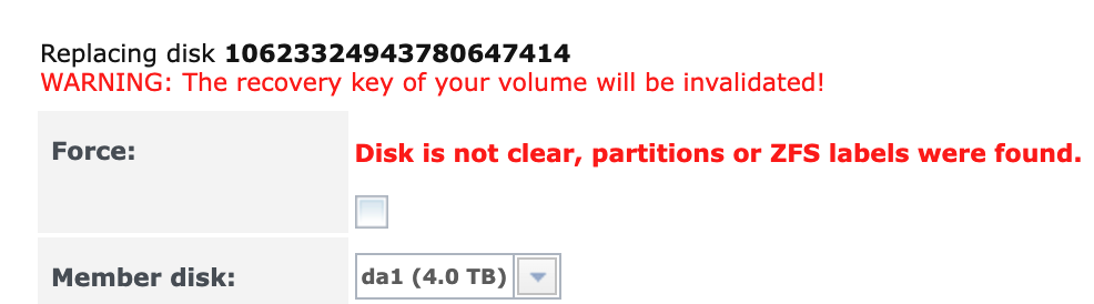

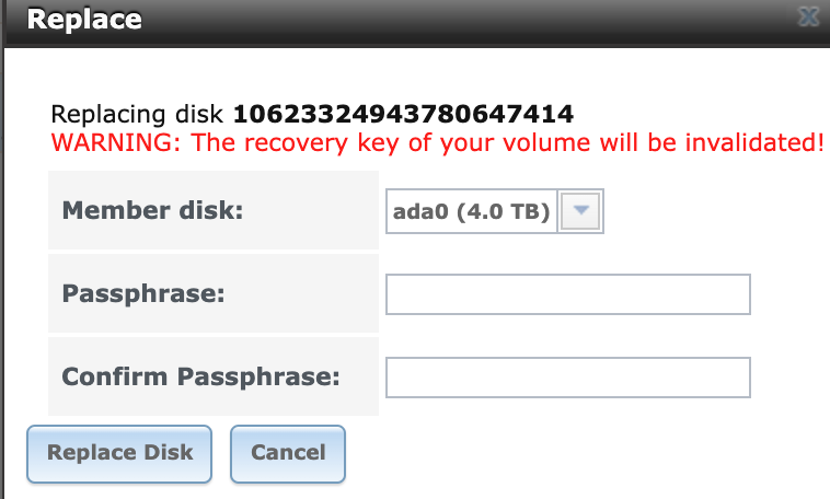

So I thought ok maybe I can just replace it with itself, but then it says this:
Pretty sure I should have offlined the old, removed it, then plugged the new one in the same slot and then did replace.. but now that I am in this situation, what is the best way to resolve?

Sorry, I meant to include this screenshot.. I suppose I could click "force" and resilver it again..
I know I'm using an ancient version, now I'm a bit afraid how I would upgrade and if it isn't broken, I guess I'm ok with this old version
9,700
That sounds reasonable... you could also wipe it from the disks view first to avoid that warning/blockage.
