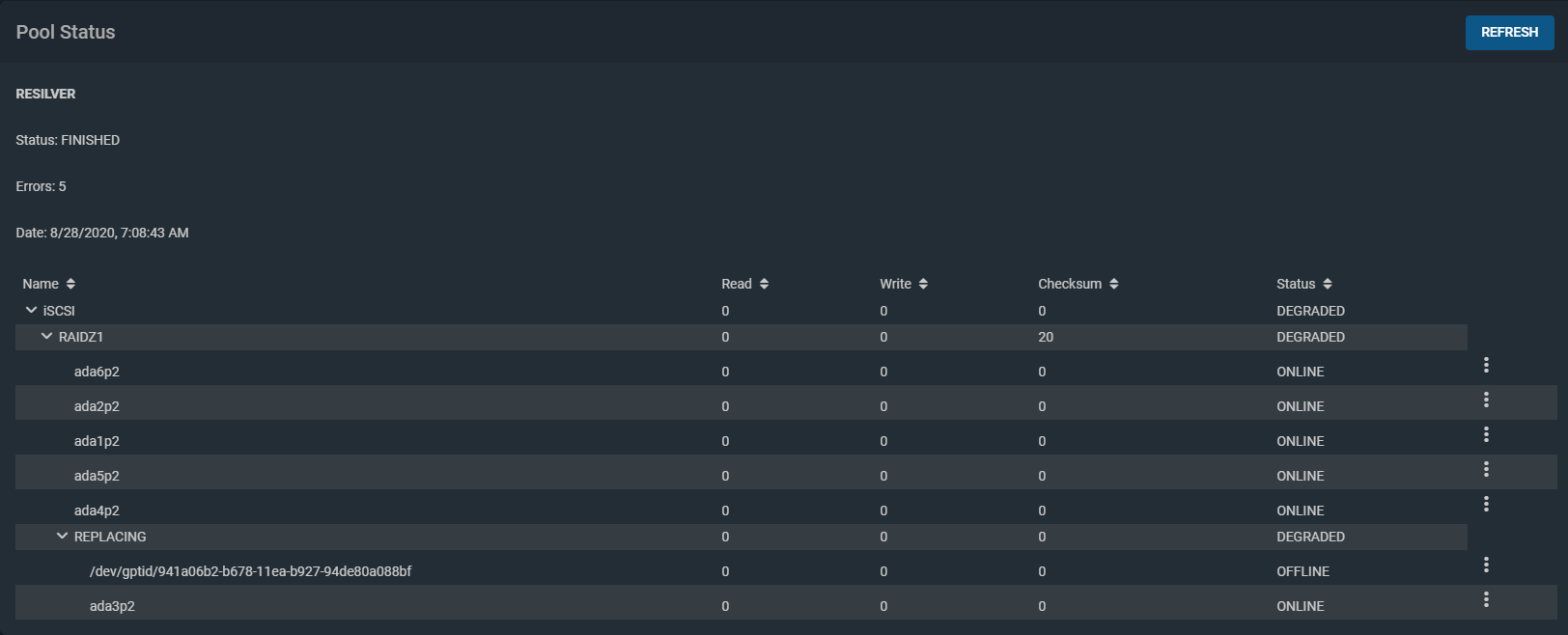

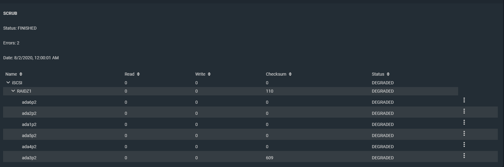

From this, is ada3p2 the bad drive?
Samuel Tai
Apr 24, 2020
5,399
Yes, it's showing checksum errors, so there's sectors where the contents don't match the checksum.

I was expecting it to show only the drive needing to be replaced as degraded. Also, smartctl -t short/long /dev/ada3 fails on this drive.
"a mandatory SMART command failed: Exiting. To continue, add one or more '-t permissive' options" is the error.
garm
Aug 19, 2017
1,556
The rest is degraded due to the checksum errors you have on the vdev.. resilver a new drive and see if that fixes your issue, but prepare to restore from backup just in case
9,700
Since it's all checksum errors, look at the cabling and power to that disk first... perhaps change the cable too if you're going to replace the disk.
Aug 3, 2019
9
I was able to replace the drive And it Resilvered. Performance is back, but the OS still shows pool as degraded. I think I need to somehow "detatch" the old drive from the OS but when I atempt to, I get errors.
