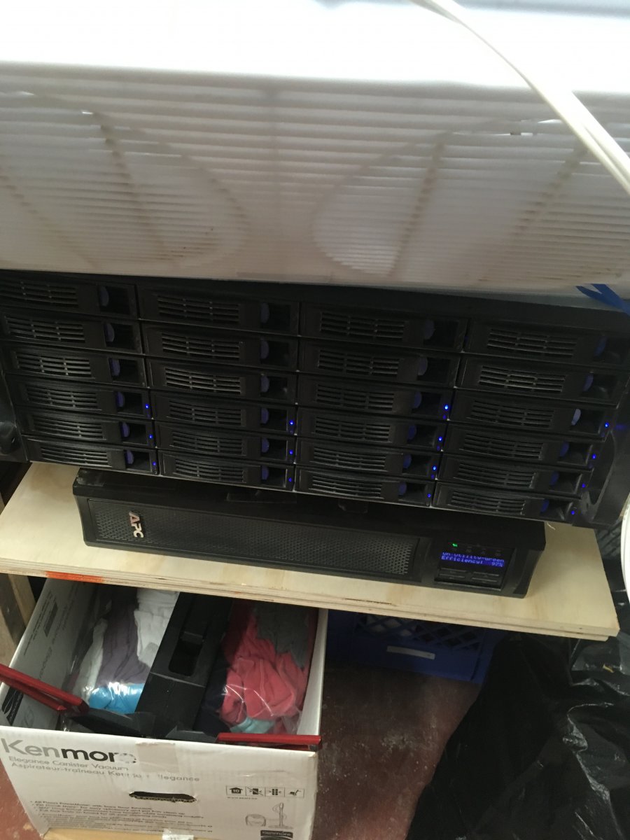

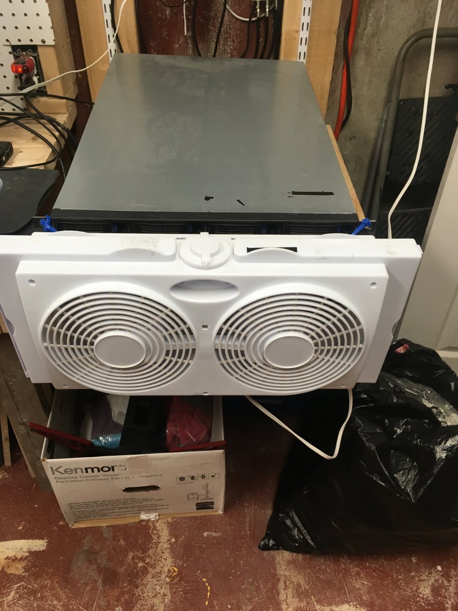

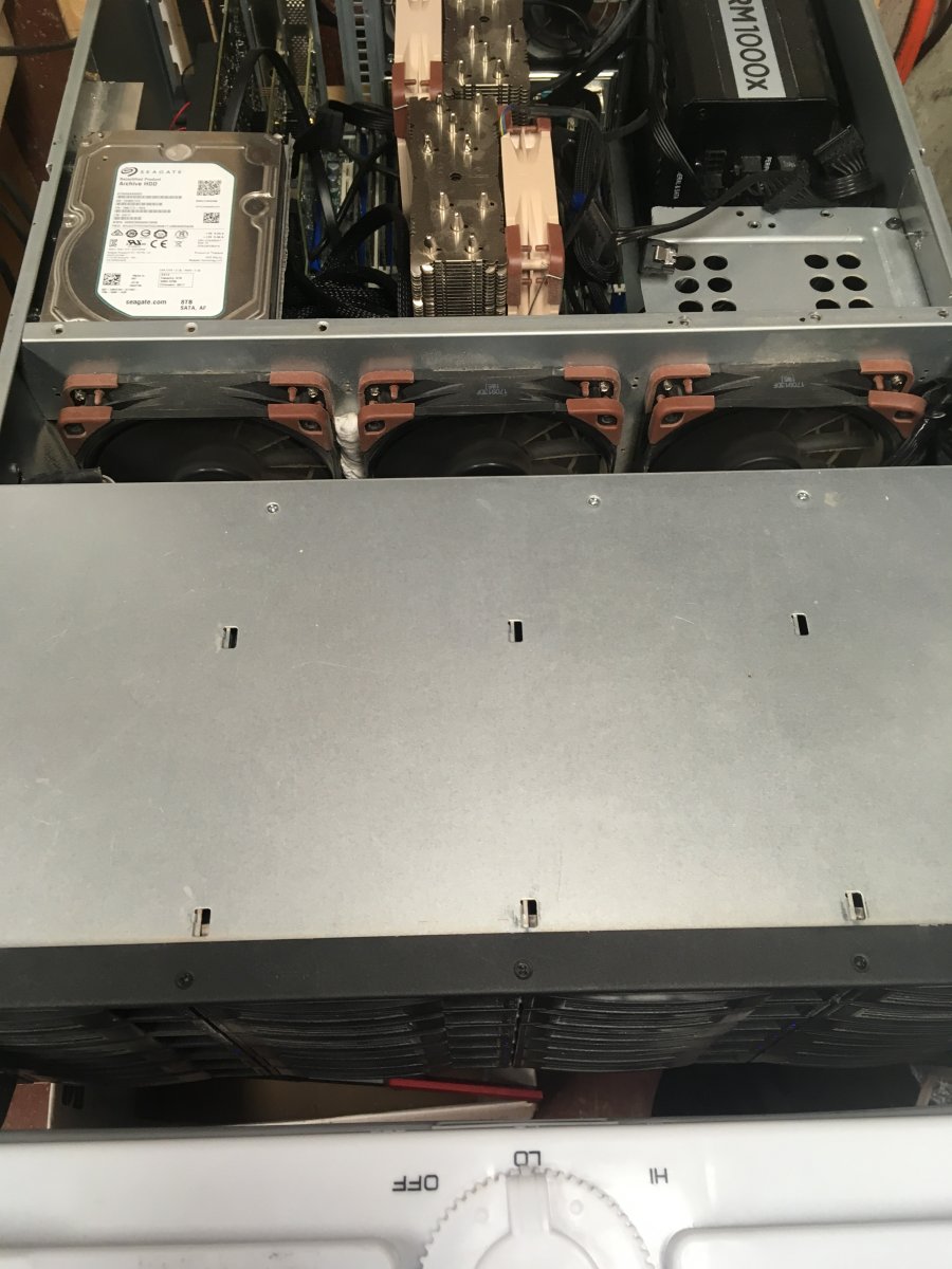

2. Cooling, The Server is located in my basement where it is relatively cool but the drives in the center tend to heat up above 45 Degrees Celsius, ever since i put a makeshift fan in front, my temps have been no higher that 38 Degrees Celsius.

Those cases are terrible about airflow if there are empty drive bays. There is a solution for that on this forum, you might want to read this thread:

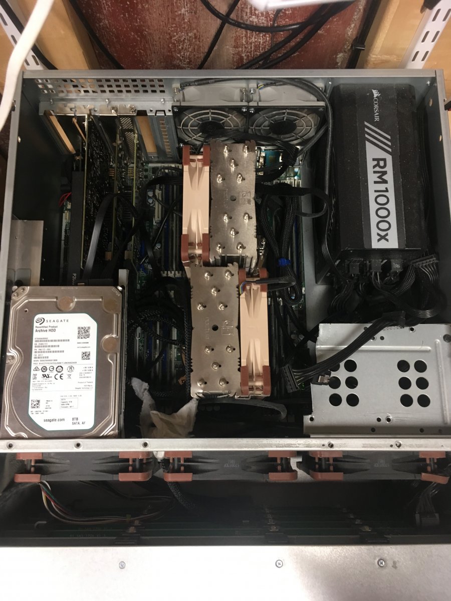

Mixture of Seagate Drives and Western Digital shucked Drives.
The one seen in the picture is one of the Parity Drives and that is connected directly to Motherboard

The Seagate Archive drives are "shingled" or "SMR" type - while there's some long-term potential for this type of drive to work very well in ZFS (once the entire filesystem has been rewritten to be optimized for them) there's some scenarios where things go pear-shaped.
In your case, the workload of long-term archival storage of movies/documents/backups is probably not too bad. Regular operation doesn't result in a lot of writes (hardly any, I'd wager) and as such the "cache" on the drives will never get overwhelmed. It will hopefully be able to reshingle itself at its own leisurely pace.
Where it will potentially fall down hard is if you ever have to replace a drive due to failure, or potentially when you expand the array in unRAID (if this causes data releveling/restriping) and your old drives end up with free space fragmentation. You could be asking for a lot of writes all over the disk, which makes SMR grind to a pretty big halt.
As long as you don't overwhelm the PMR "cache" on the Archive drives it should be fine, but keep a close eye on performance of sustained writes long-term. The initial load onto clean LBAs should be fine, it'll be when you go to rewrite data that it can choke up.

....But that case does. The OP clearly needs a better case, one that is engineered for that many drives. Squeezing stuff in and compromising air flow to the point where a room fan is used to supplement the interior fans is a sure sign that not all is well.
Supermicro cases on eBay are cheap and can hold both the drives and the motherboard in happiness. Or go the chenbro route. Or the storinator at 45 drives.
With that much data/$$$ tied up in a single system, I’d be looking at redundant PSUs and ups’s. It’s odd to spend literally thousands of bucks for the storage drives only to skimp on the underlying hardware.
