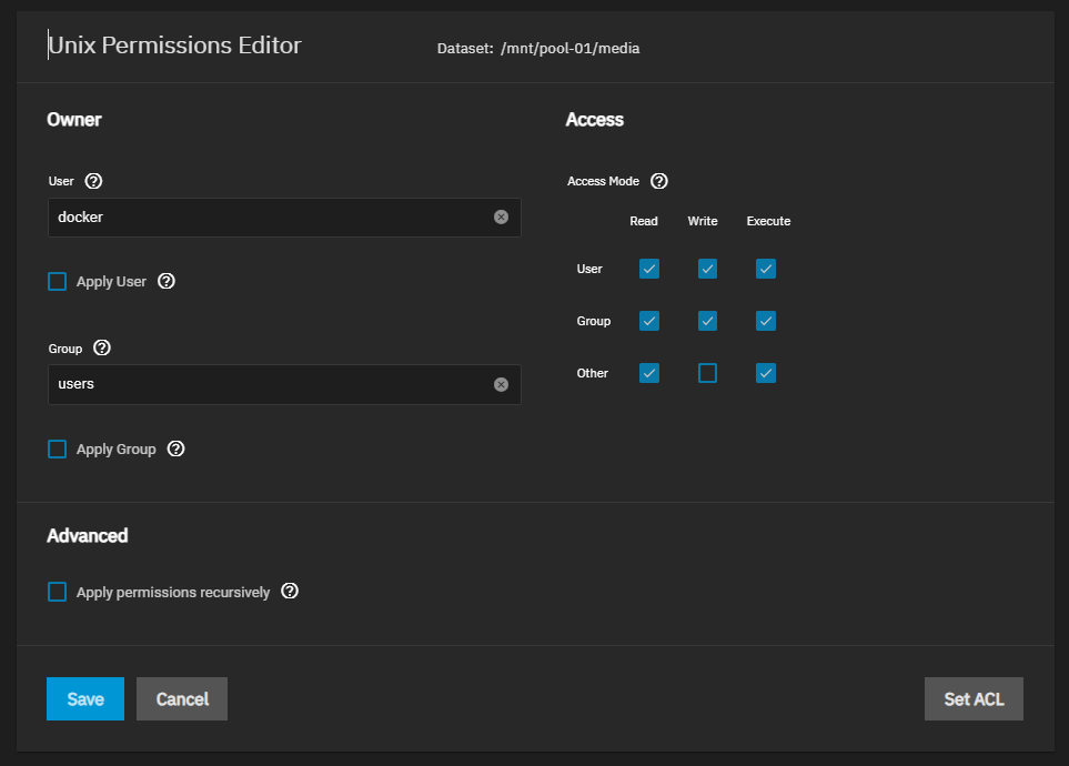

I setup a new Scale server and moved data from an OMV server.
I'm having issues with the SMB shared files. The folders are showing, but the contents aren't. If I use WinSCP to change the permissions to 6775, set UID/GID, and recursive, the folders are then accessible.
WinSCP is slow, so I've tried to use Edit Permissions in the TrueNAS web gui. When I run that with 6775, etc (same as above), it doesn't set the execute bit for Other, which seems to be needed for guest access via SMB.
Pretty much wide open like this isn't the goal, but for now I'm just trying to get it up and running.
Are there any easy ways to reset all the perms? I'm guessing the perms were preserved when I copied them from OMV and they're causing problems.
