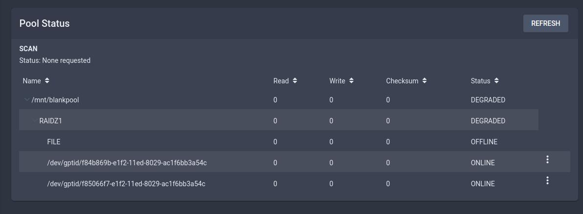

As I'm investigating different avenues forward for my storage configuration, I tried this resource guide out.
As it turns out, it requires some tweaks as of TrueNAS-13.0-U4.
The problem I ran into:
At the stage where the pool is reimported, the GUI no longer allows you to do the replacing step from the offlined file.
Turning to CLI, there is not much luck either:
zpool replace -f blankpool /root/sparsefile gptid/ed391415-e1ef-11ed-8029-ac1f6bb3a54c
cannot replace /root/sparsefile with gptid/ed391415-e1ef-11ed-8029-ac1f6bb3a54c: already in replacing/spare config; wait for completion or use 'zpool detach'
The problem appears related to ashift.
When the pool is created as per the guide, it defaults to ashift=9 (which somehow registers as "0" in zpool get all?)
truenas# zpool get all | grep ashift
blankpool  ashift                         0                             local
boot-pool  ashift                         0                              default
tank         ashift                         12                             local
In order to avoid the error, it would require to specify ashift=9 when replacing the drive.
That would look something like zpool replace -o ashift=9 -f blankpool /root/sparsefile gptid/asdf...
When doing that however, the drive will have cause the output of (sorry didnt save explicit example) zpool status -v blankpool that indicates the replaced drive has 512b instead of 4096, ie indicating explicitly added with ashift 9.
My suggestion is to avoid all of that, to have the pool line up with "what would come out when using the GUI".
Enough problems! Here's a solution that worked out today:
Create the pool specifying ashift=12:
zpool create -f -o ashift=12 blankpool raidz1 /root/sparsefile gptid/f84b869b-e1f2-11ed-8029-ac1f6bb3a54c gptid/f85066f7-e1f2-11ed-8029-ac1f6bb3a54c
Then the replacement will follow nicely at the later steps:
zpool replace -o ashift=12 -f blankpool /root/sparsefile gptid/f3ec7e13-e1f1-11ed-8029-ac1f6bb3a54
This generates a clean looking pool.
