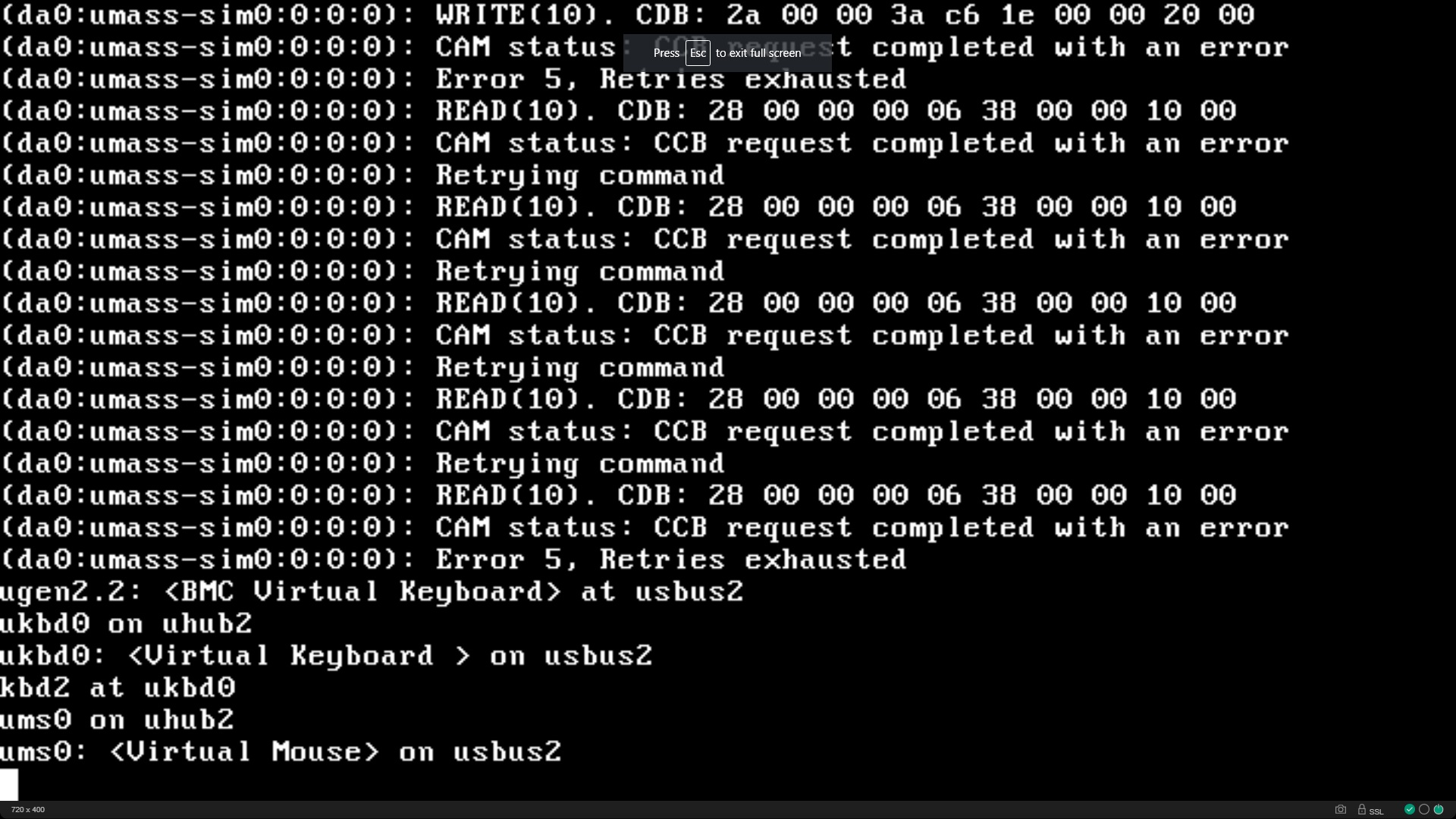

It initially seemed fine but I was finding withing 24H it would become completely unresponsive. (jails still seemed to run ok. (plex).
On some occasions i could get error output:
System wouldn't respond to reboot request. Reboot seemed to resolve the issue, but it would happen again the following day.

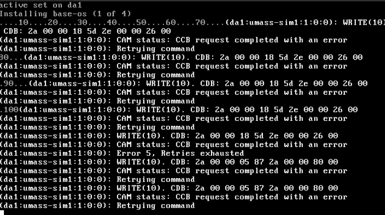

Thinking it might be the USB stick I Tried a fresh install on another stick.
Same problem.. I get CDB errors (Read and write) either in the middle if installation or shortly after.
I have tried 4 different memory stick of differing models and the problem persists.

Those sure look like legit errors on the boot-media. Can you try installing to a non-USB device? Would be a good way to determine or rule out if its USB media issues quickly.
