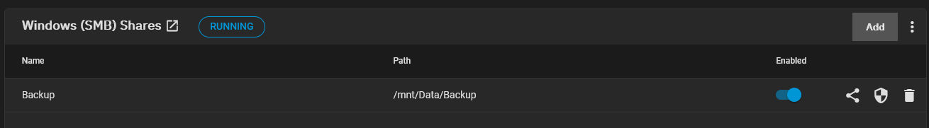

I am trying to set up the ACL for a SAMBA Share on BlueFin

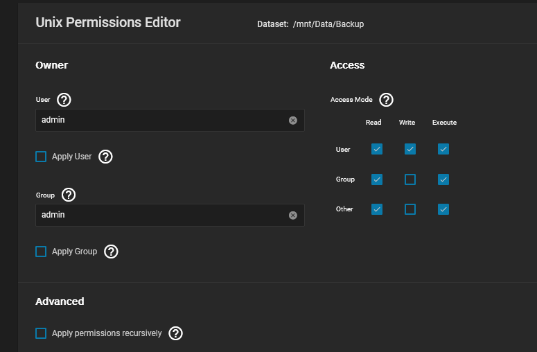

On the dataset I changed the owner from ROOT to ADMIN
When I try to rsync to this share from a Centos 7 machine, I get this permissions error:

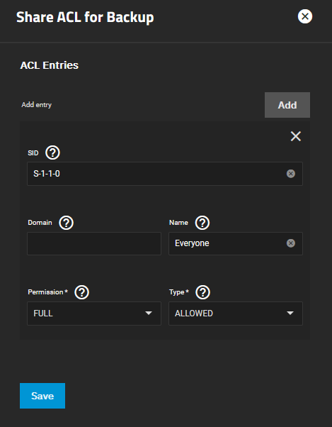

My thought is that I need to create a Share ACL:
I have read that BlueFin has some WebGui issues, I have not found any howto examples to manage SMB shares via the CLI

Is admin a group?
Does john have permissions?

I nuked everything and put it back in
The sid acl was my issue I figured
I changed the owner from root to admin based on some information I read about can't be root, not sure if true but seems to working now

The issue I had was using an incorrect SID in the Share ACL, once I fixed the SID everything worked as designed.
