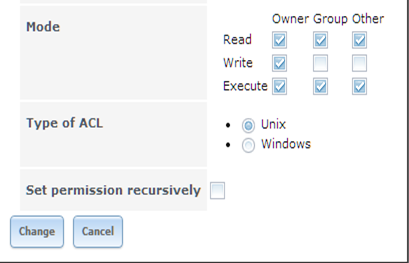

I have the exact same use-case as fishinfiend (owner: full access, others: read-only), and have set up my CIFS shares nearly as Dusan describes (single share with differing permissions for owner and others, although "Set permission recursively" is not set), but was thoroughly surprised to find that others could still delete files from these shares when I tested with other accounts. I have another CIFS share (on the same volume) for backups with dedicated user access, which behaves properly (only owner & users can read/write/execute, others are read-only). During testing, I can remove the Read and Execute permissions separately, and other accounts are properly denied. I am perplexed as to why I can't seem to get this working. Any thoughts about what to try? I've attached an image of the CIFS permissions. Thanks in advance.
