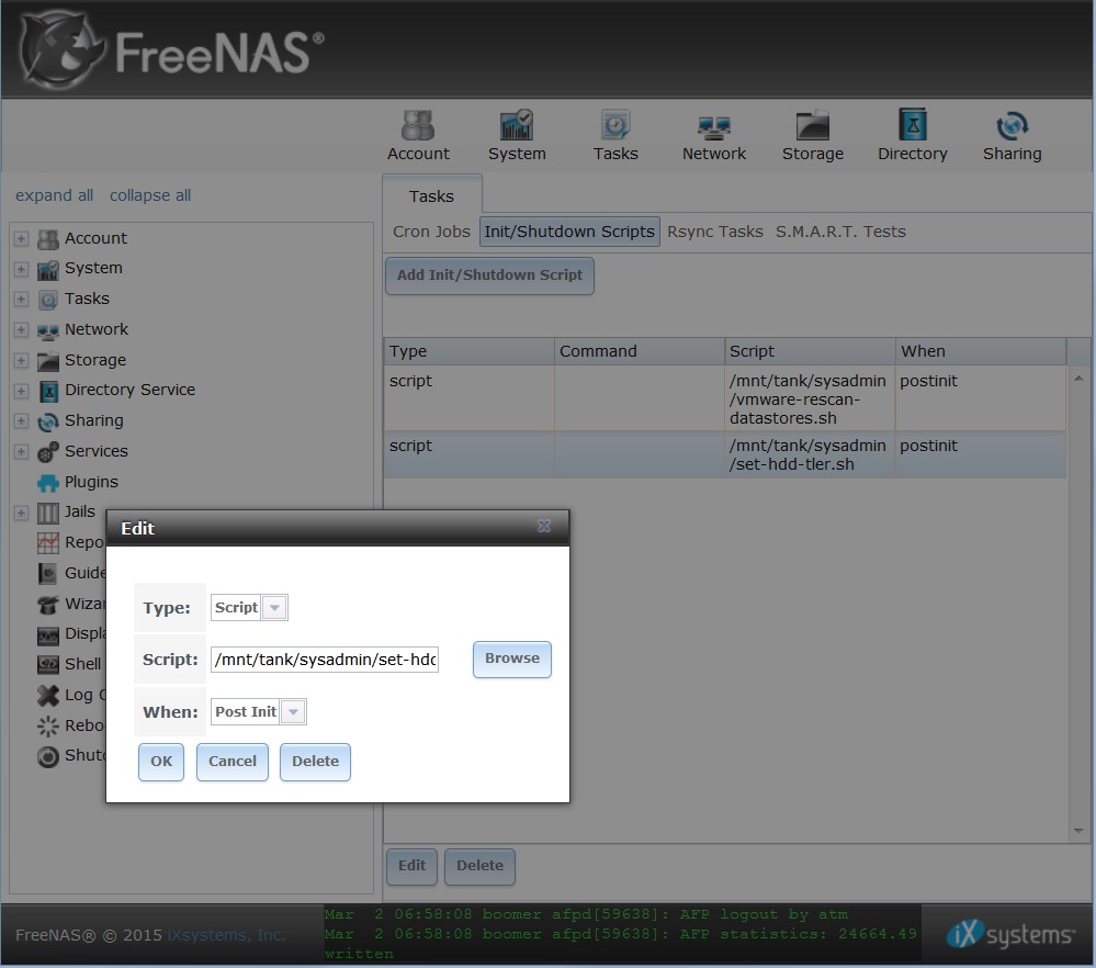

@RoboKaren, the shell script (named set-hdd-tler.sh, see below) is in my 'Systems Administration' dataset located at /mnt/tank/sysadmin. You'll need to tweak the script to reflect the number of drives in your system and how FreeNAS assigns device names to them:
smartctl -l scterc,70,70 /dev/da2
smartctl -l scterc,70,70 /dev/da3
smartctl -l scterc,70,70 /dev/da4
smartctl -l scterc,70,70 /dev/da5
smartctl -l scterc,70,70 /dev/da6
smartctl -l scterc,70,70 /dev/da7
smartctl -l scterc,70,70 /dev/da8
I set it up to run at boot-up as a 'postinit' script using the 'Init/Shutdown Scripts' selection under 'Tasks' on the FreeNAS top-level menu (click on thumbnail for details). Be sure to specify the correct path to your script.
