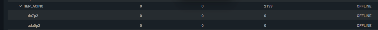

@dlavigne I went back in and selected Replace on the da7 disk, selected the replacement ada0 disk, checked the Force box and the system took off with no complaints...... go figure. Currently at 3% resilvering, so far so good.
TAC
Feb 16, 2014
152
@dlavigne since resilvering kept resetting to 1% I ended physically unplugging drive da7 and then resilvering completed with no more resets. Iisted below is a portion of the log file that appears to show serious problems with drive da7.
Side note, I thought was interesting that the FreeNAS Dashboard did not report my pool as DEGRADED when REPLACING the the da7 drive. As expected, when I physically unplugged the da7 drive the pool was reported as DEGRADED.
