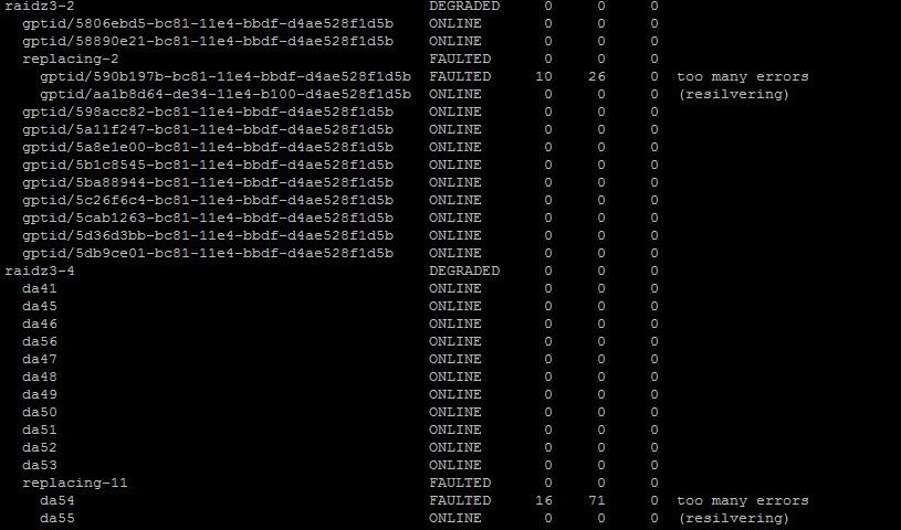

This might be a GEOM related issue. So basically I had a zpool with three 12 disk raidz3s (all 4TB disks) and I went to add another 12 disk raidz3 to it (this one with 6TB disks). zpool add storage01 da51 da52 da53 etc,.
It added them without issue although instead of "GPTID" I get just "DAXX".
Anyways I went to replace a failed 6TB disk from the gui and it failed saying "Apr 8 15:32:18 fs05 manage.py: [middleware.exceptions:38] [MiddlewareError: Disk replacement failed: "cannot replace da54 with gptid/1c18ceeb-de3f-11e4-b100-d4ae528f1d5b: device is too small, "]
I SSH'd in and did a zpool replace /dev/da54 /dev/da55 and off it went ( see S/S below).

It's not working via the GUI, since you created it in the CLI, using whole disks.
FreeNAS is an appliance and it expects you to create the vdevs using the GUI, according to it's rules. For example, it would create a 2GB swap file on each disk and create the vdev using gptid's. With a swap file on each disk, should you need to replace a drive with one that's a few bytes larger, it can adjust the swap file to make it work.

Yeah after doing more research I came to the same conclusion actually.. but now that I have done this, will it cause any issues and can I fix it?

It will probably cause problems and you can fix it by rebuilding your pool.

Basically, at your next opportunity, you need to blow away that zpool and recreate it. Until you do, there is a possibility that you might do a reboot, upgrade, etc (something very minor) and suddenly your vdev is trashed and the pool is gone. :(
