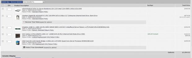

Looks like the area near the PSU will work. I got a 128GB SSD, figure thats about all we'll need for L2ARC.
Here's the parts list
Not bad! I'm gonna try this server out first, just to verify it is gonna do what we want it to. If it works great, then we'll either get another or go to a higher speed unit for heavy traffic. I'll also order some of the breakables as spares, because ASUS's turnaround i know is horrendous. Spare board, memory, PSU, hdd and ssd
jgreco
Resident Grinch
May 29, 2011
18,680
Not your first rodeo, eh. You're in a good place to be doing this sort of thing, then.
