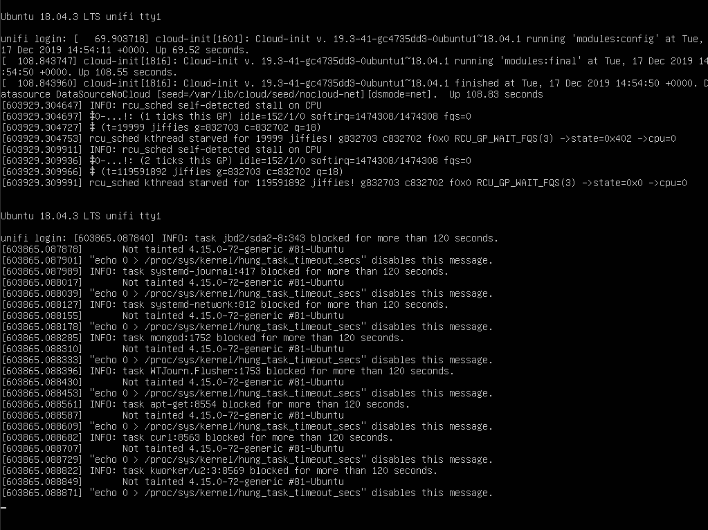

I'm seeing a similar issue on much higher-spec'd hardware doing far less:
OS Version:
FreeNAS-11.2-U7
(Build Date: Nov 19, 2019 0:4)
Processor:
Intel(R) Xeon(R) CPU D-1518 @ 2.20GHz (8 cores)
Memory:
64 GiB
The VM is Ubuntu 18.04 with 1 vCPU, 2 GB RAM, AHCI Disk*. The only thing it's doing is running the UniFi Controller.
* This hasn't been a problem lately but I'll switch it to VirtIO just to be sure.
