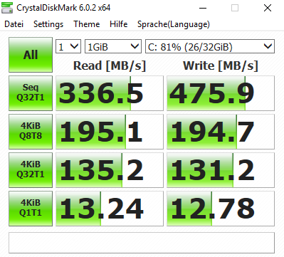

at the Moment ive configured 4x Sandisk 800GB with RAID 10 - Sync Option enabled > If i run CrystalMark the Results over 10GBE are
ill hope there is more possible in the right configuration (see my question below)
