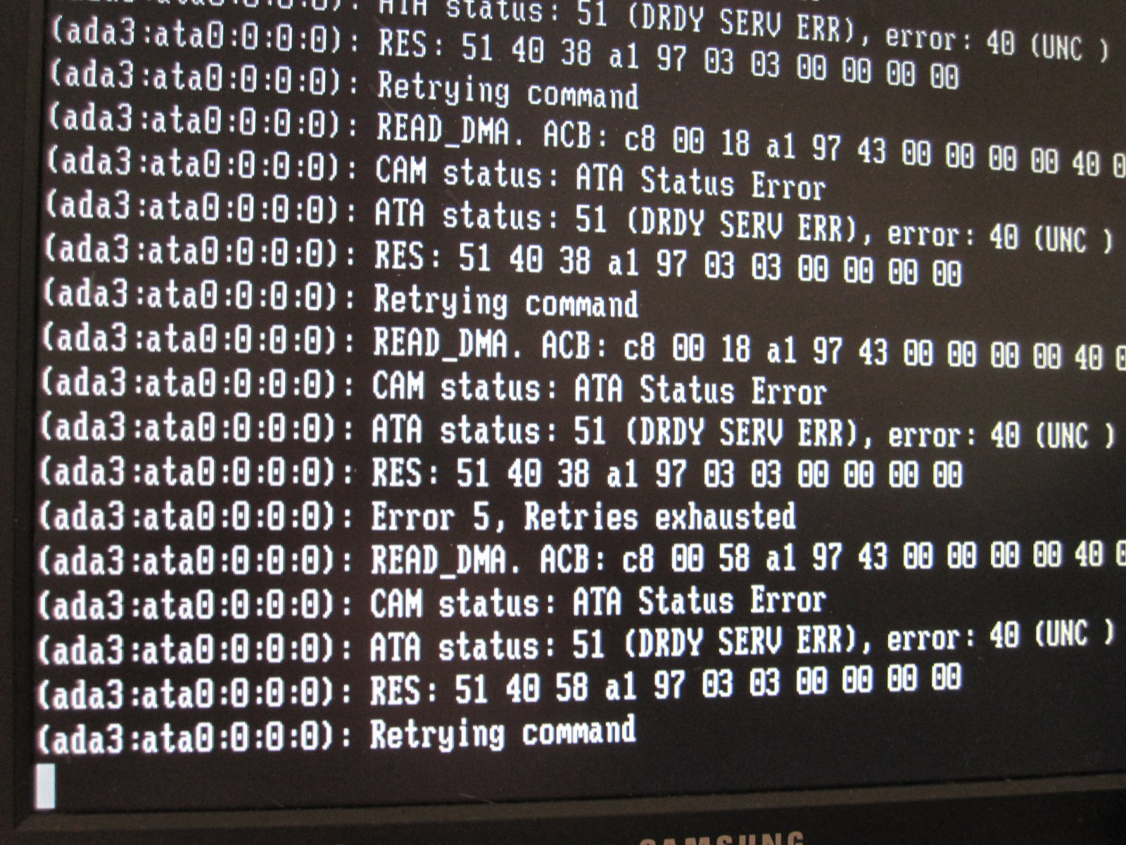

19
And now this (see screenshot) on another drive. Maybe I need a new motherboard, or replace the SATA cable.
