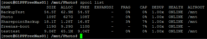

That sounds rather unusual. Please post the output of zpool list. Before the rename test, were you renaming it before?

zpool list
iScsi is the item name 'Photo'
