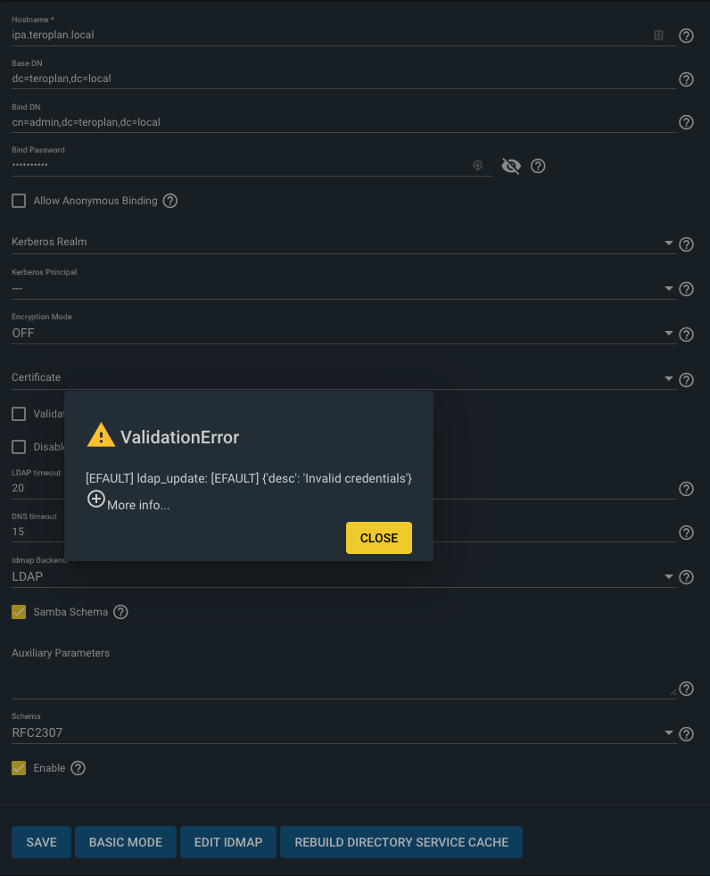

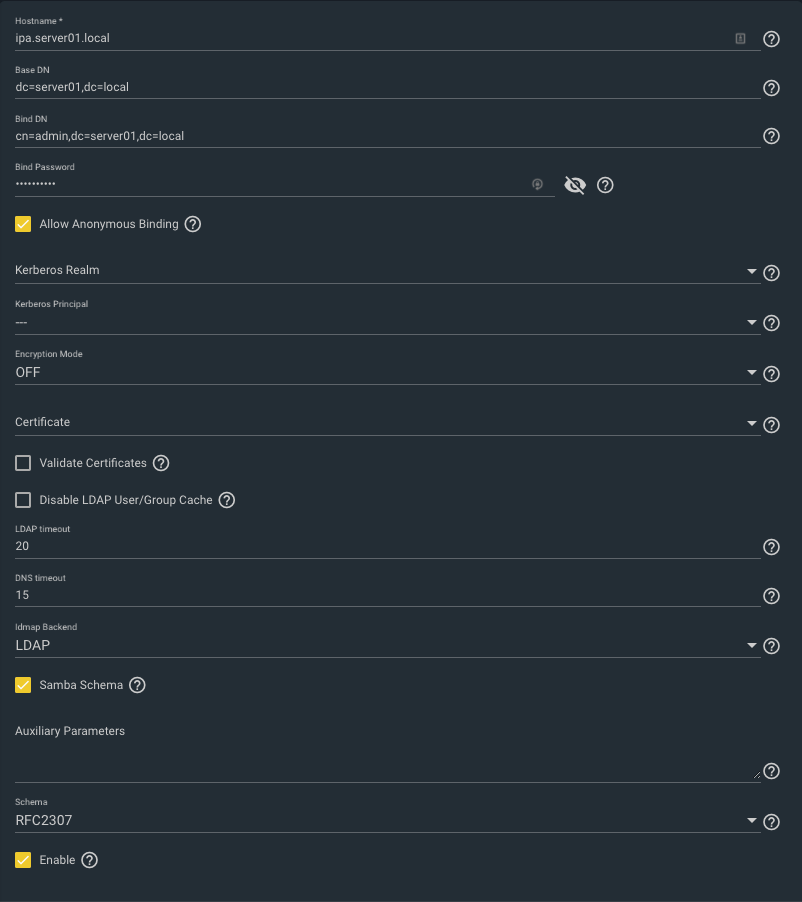

Directory Services -> LDAP
hostname: ipa.server01.local
BaseDN: dc=server01,dc=local
BindDN: (password to admin IPA account)
Samba Schema: enable
here I have a problem:

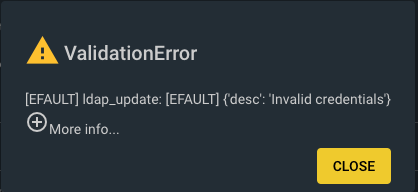

if disable checkbox: Allow Anonymous Binding then -> have a ValidationError (Invalid credentials)
if enable checkbox: Allow Anonymous Binding then -> No message and LDAP is starting work :)
