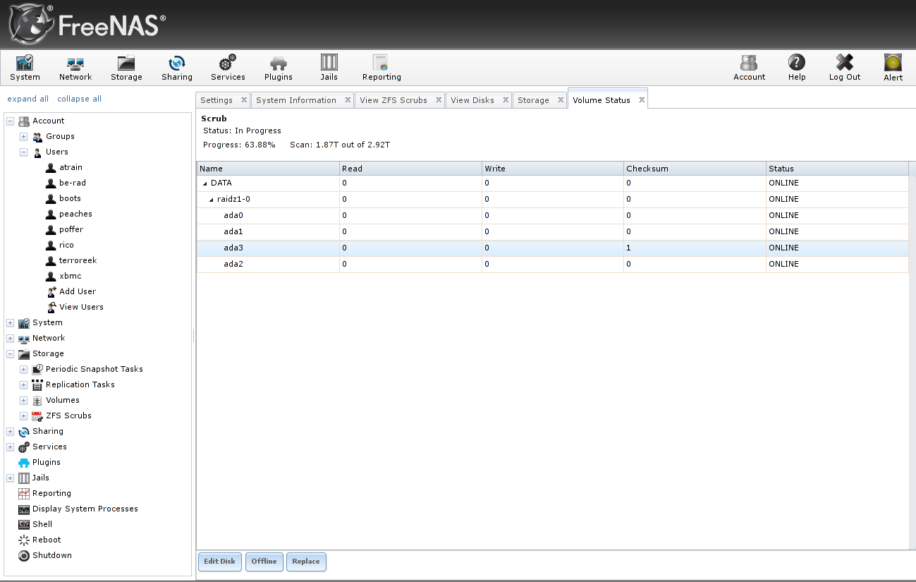

I am wondering if anyone has run into this issue, but all of a sudden my NAS is throwing out this error (see below from dmseg.today and console). It's just repeating and I can see that one of the drives activity lights is just on, not flickering at all. I am running FreeNAS-9.2.0-RELEASE-x64 (ab098f4), now in the status icon, I have a warning it reads as follows;
WARNING: The volume DATA (ZFS) status is ONLINE: One or more devices has experienced an unrecoverable error. An attempt was made to correct the error. Applications are unaffected.Determine if the device needs to be replaced, and clear the errors using 'zpool clear' or replace the device with 'zpool replace'.
When I take a look at the volume status (see attached), it shows everything as online. I know there is a scrub that's running. Any ideas what the issue might be?? I don't think its a drive failure, but it could be. Any insight would be appreciated. Should I just run zpool clear and see if that fixes it??

cyberjock
Inactive Account
Mar 25, 2012
19,525
Didn't try to search for that error, huh?
ada3 is failing and needs to be replaced.
