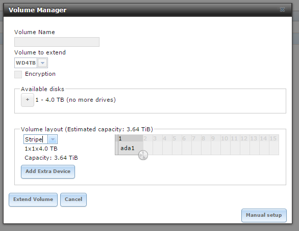

OK. I have built my new FreeNAS 9.3. Rsync'd all my data from the old FreeNAS 4TB to the new FreeNAS4TB.
I have physically installed the old 4TB in to the new FreeNAS server.
How do i setup mirroring from here?
Do i create a new vol or exend the existing vol? And do i use Stripe or Spare??

gpsguy
Active Member
Jan 22, 2012
4,472
None of the above.
You will need to use the command line in order to mirror the drive (after the fact). The commands have been posted and referenced several times in the past 40 days. Please search the forum.
If you have access to a virtual environment you might want to do a dry run first.
