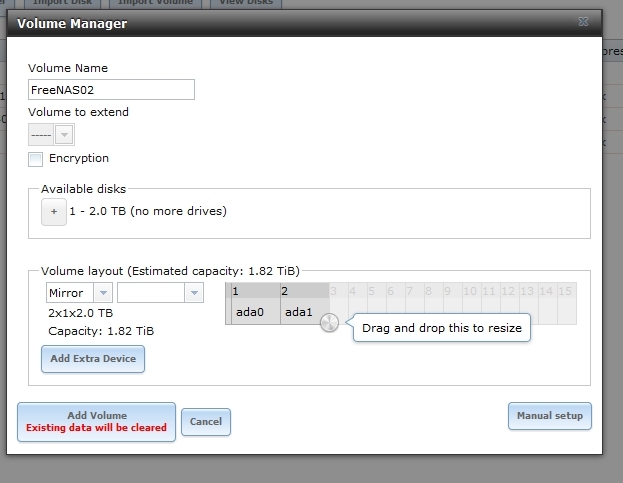

Danb35: In Volume manager, I enter "FreeNAS02" into the box for volume name. I am not able to alter anything. The attached file (pic2.jpg) is a screen grab of the Volume Manager. Note that the two new drives at ada3 and ada4 are not selectable or displayed. pic2.jpg
nightshade00013: as you can see from the screengrab, putting a new volume name in the box does nothing to display the two new disk drives.

You have one disk showing where it should be. So only one is missing. Do a zpool status and you will see the layout of the disks. You may have attached one of the ones you wanted to use as a new volume as a spare or something else.
15,504
That's exactly correct. Click Add Volume and you'll have
I think you've misread that.
@Craig Kawahara, what you're seeing is exactly what you should be seeing. The new disks are ada0 and ada1. Click Add Volume and you'll be set.

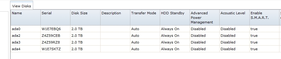

@danb35: Under disk view, there are four drives displayed, ada0 thru ada4. My understanding is that ada0 and ada1 are the drives comprising the volume Freenas1. The drives I want to use should be ada3 and ada4. Correct?
See the screengrab below....note the display shows ada4.

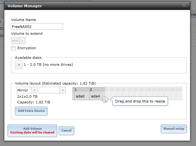

@nightshade00013: You might have something. I moved one hard drive controller connection from the pcie card to the one remaining sata connection on the modo. Freenas (see screengrab below) now shows that ada4 is available. It is now my guess that contrary to my assumption that it was doing it's job, the controller is doing something that makes the drive reconzigable but not usable to Freenas.
So now it seems my issue is to resolve why the pcie expansion card enabled Freenas to see the two drives ( the platform pc was a Dell SC440) while the same card in the permanent box (the Dell PE840) fails.

Maybe I'm just being dense, but I still don't see the problem. Here's what I'm seeing:
  • You have an existing volume called Freenas01, which is a two-disk mirror.
  • You have two more disks that you want to use to create a second volume called Freenas02, which will also be a two-disk mirror.
  • The volume manger sees the latter two disks. It shows them in there as ada0 and ada1 in the first screen shot you posted, and as ada0 and ada4 in the more recent one. These can only be the unused disks, because the volume manager only shows unused disks (it won't let you use a disk that's already part of a pool). They have to be the same disks, because you only have two unused disks in your system.
  • So, if you want to create that second volume, in either of the screenshots you posted, click Add Volume and you'll have it.
Clearly this is not correct, because the volume manager is giving you ada0 as one of the unused disks.

@pirateghost: Sorry, but that is what the displays show. If not ada* what is expected to be displayed? the GUI shows only ada#. Zpool (I founf the "|more" option displays volumes (such as FreeNas01 (in my case), and mirror-0, and huge alphanumeric strings which do not appear in the GUI option boxes. How is one to use other than ada. Sorry for being a newbie.
15,504
The problem is that drive numbers are not deterministic. The piece of hardware that the system calls ada0 today may or may not be the same piece of hardware that it calls ada0 after a reboot. The GPT IDs (the "huge alphanumeric strings" you mention) are consistent--a given string will always refer to the same device.
You thought your initial two-disk mirror consisted of ada0 and ada1. That may well have been the case when you created it. But now, those drives are called something different, apparently ada2 and ada3.

To close this thread, I would like to report that the second FreeNAS volumne was created, and Yes, as it was told to me, my belief that the drive designations was incorrect. The drive designated ada1 in the Drive View was not the ada1 drive in the displayed drives used in creating the volume in Manager. Volume Manager shows two volumes each with 1.8TB.
