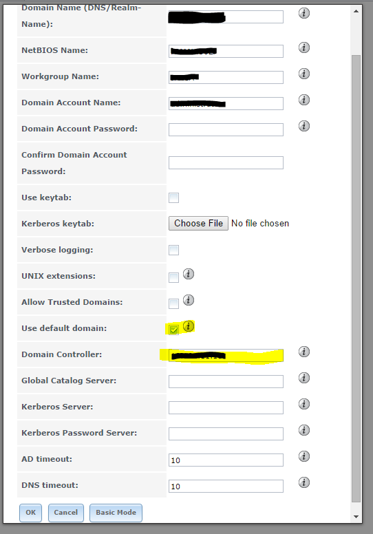

Skinner
Sep 17, 2014
I had issues with this also.
I found that you need to tick a few boxes in the advance menu sorted it out for me. The blacked out lines are the boxes i added config to. The ones highlighted are those I added in the advance menu.
