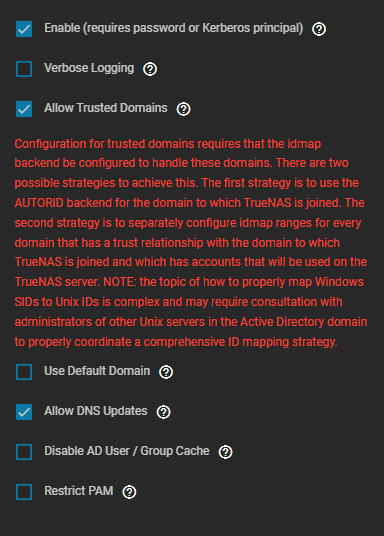

Bug #1 - Can't enable "Allow Trusted Domains" unless an "AUTORID" backend is enabled.​
If you try and check the "Allow Trusted Domains" while an RID backend (the default) option is selected, you get this long and cryptic error:
In my opinion, this warning is important, but in this case it prevents me from saving this configuration! I have to change the backend to AUTORID before this will let me save, clear the cache, then come back to set it again.

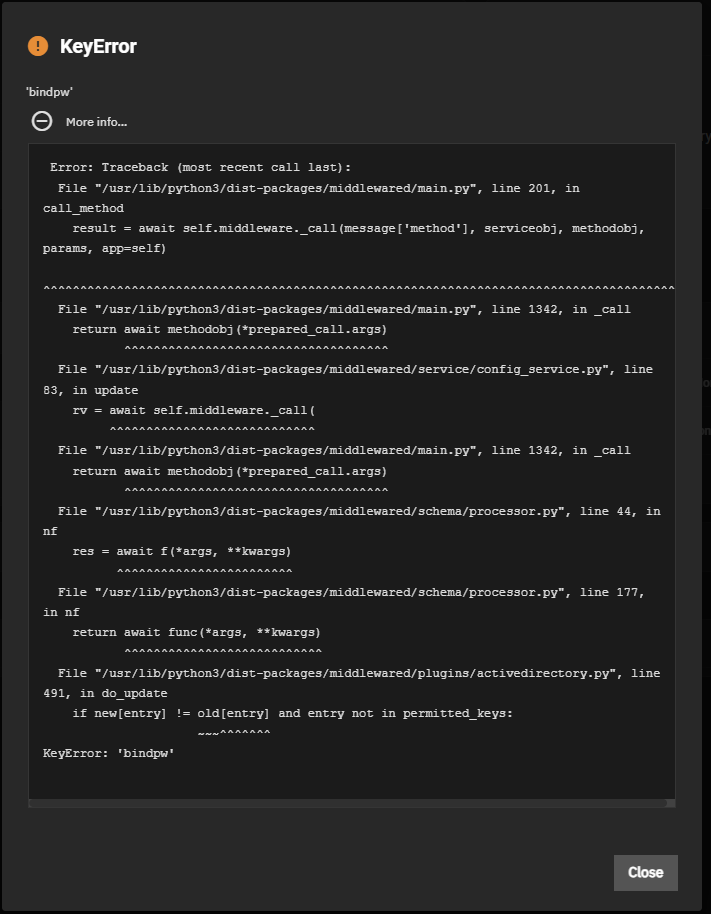

Bug #3 - Bind password not being saved​
There is a check that happens in the activedirectory.py file where it checks if there are any modified entries, but it seems like the 'bindpw' entry is missing from the old configuration. The python script doesn't check for key existence before attempting to access, so this raises.
This is especially annoying because I can't enable the "Use Default Domain" option now. In order to change this, I need to leave the domain, and join again so that there is no old configuration.
