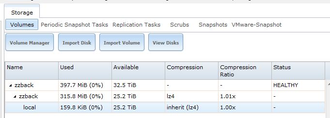

Newly created volume (pool) and filesystems. No data -- no bulk copy from anywhere, and just one new directory and an authorized_keys file added. So there shouldn't be any confusion about space yet.
Why are there two levels of "zzback" with different sizes? The outer one looks like the right size -- what's physically installed is 6x6TB in RAIDZ. So why does the inner zzback have 7TB less available? (Local I created myself, and have created on home directory for a local user in it.)

You loss 6TBs for the parity disk. There is also some overhead space for ZFS for Metadata and such.

6x6 is 36, minus 6 for parity is 30; and I would expect the subtraction for parity to already appear at the top level. Isn't that the "volume" (pool). (I'm much more familiar with Solaris ZFS, so the terminology here sometimes escapes me.)
This may get back to what exact construct each level of that table reports. Is the first zzback the volume (pool), or something else? What is the second zzback? "Local", at least, I recognize as a filesystem; one I created myself.
And *7TB* going missing is wrong for 6TB drives. So any way I look at it the numbers don't add up. (The FreeNAS reports are in 1024^n units whereas the disks are sold in 1000^n units, so I'm used to a 6TB disk being reported as 5.3TB or some such in an OS. So the difference being *7* TiB where the difference in disk sizes is *6TB* is hard to reconcile.)

The top level doesn't subtract parity... The conversion from TB (1000^n) to TiB (1024^m) is more like 5.45 for your 6 TB disks. Multiply that by 6 disks, and you get the 32.5 TiB shown for the pool.
The second number subtracts 5.45 for parity, and as DifferentStrokes noted, there's also "overhead space for ZFS for Metadata and such", which in your configuration appears to be about another 1.8 TiB.

Actually I have 5.46 TiB for a 6 TB drive, 32.7 TiB for the whole RAID and 27.3 TiB for the data space.
Then you need to account for the overheads and as you're not using 3, 5 or 9 drives the pool isn't aligned and this overhead is pretty big, something like 5 % (at least two others members also see a big overhead due to not aligned pool).

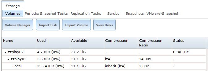

If I may ask, could you please repeat creating your pool this time with only 5 disks and post here the same screenshot ? Please... Thank you in advance!

[...] I would expect the subtraction for parity to already appear at the top level. Isn't that the "volume" (pool). (I'm much more familiar with Solaris ZFS, so the terminology here sometimes escapes me.)
This may get back to what exact construct each level of that table reports. Is the first zzback the volume (pool), or something else? What is the second zzback? "Local", at least, I recognize as a filesystem; one I created myself. [...]
The first line is the raw size of your RAID-Z (raidz) pool. Think of output from zpool list.
The second line shows the size of the dataset that got created when you created the pool, and that dataset is associated (one to one) with a ZFS filesystem. Think of output from zfs list.
