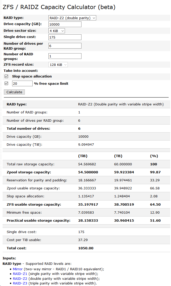

Here is a link to a fair calculator to use in deciding how much "usable" capacity will remain after all overhead is accounted for AND the fact that you should not fill a ZFS storage pool above around 80% capacity.
https://wintelguy.com/zfs-calc.pl
Also, keep in mind that, as a best practice, you are not supposed to use less than RAIDz2 with spinning disks larger than 1TB.
The attached graphic is a suggestion:

PS. I didn't make the cost accurate.

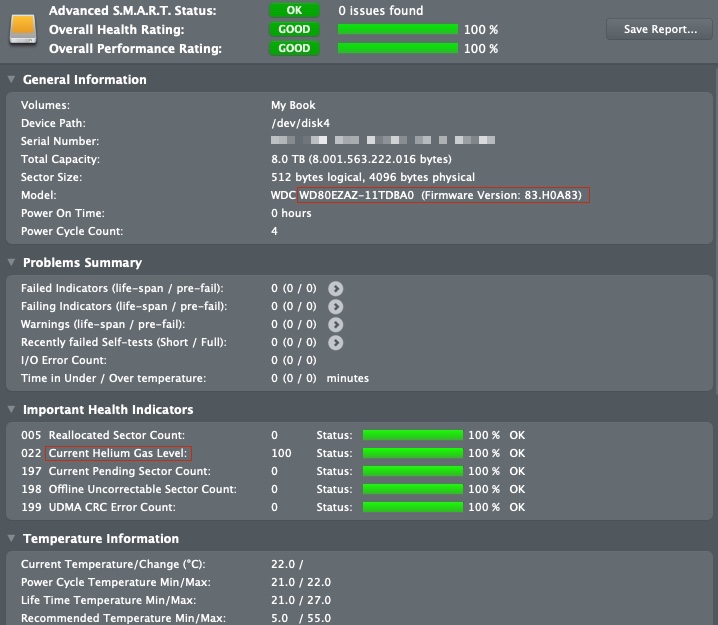

Ok, my 8TB WDs "My book" have arrived.
Just a quick tip: if you own a Mac (also possible with Linux and Win of course; please take a look at the compendium mentioned above) and want to know what you get before you "free" the HDD I recommend DriveDX for MacOS (can be done via CLI of course too).
Just connect the drive as you would normally do to your Mac, fire up DriveDX and... see for yourself :)
So this is most definitely an enterprise class HGST Ultrastar He10-8 SATA but you may have the 3.3V pin problem. You know that before you shucked it and now you can decide if you really want to risk further trouble. For me I must say I'm not quite sure but still hoping that having a very modern PSU I may not have the 3.3V problem with this drive... :oops:
