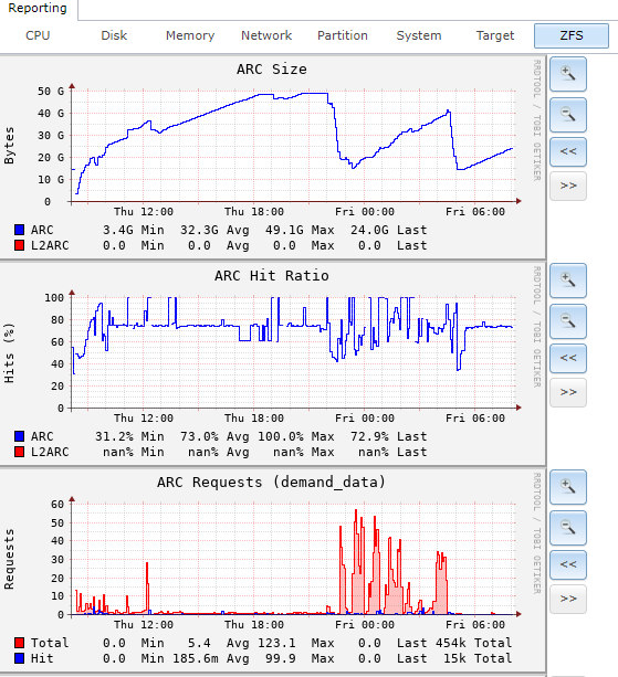

I have 11.1u7 setup as a Webdav server. Almost every other service is turned off. Raidz2 64TB with 64GB ECC Ram and no tuning. I have some Windows server backing up to this system overnight via Webdav with a Backup software. A few weeks ago, the Freenas system started locking up every night with swap_pager_getswapspace failed. Upon investigating, the system was using 100% swap space. I then tried enabling auto tune. The system became unresponsive much quicker with auto tune turned on the following night. I disabled auto tune, but left the vfs.zfs.arc_max=61776000000. The next night the web interface became unresponsive and dmesg showed sonewconn: pcb 0xfffff80152eaeae0: Listen queue overflow: 193 already in queue a waiting acceptance (16 occurrences). I have attached the netstat -Lan and swap output. Any suggestions?

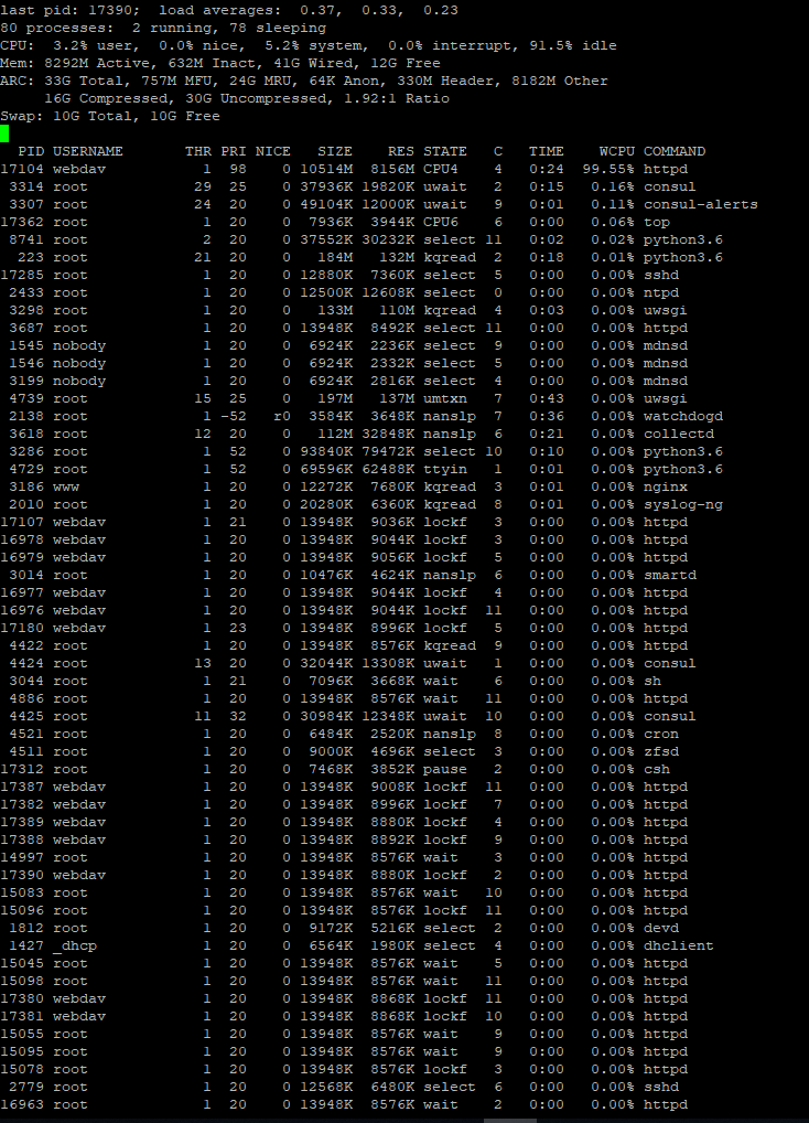

What does top look like during a backup from your servers?
fr0stbyte
Apr 4, 2019
8
I don't know what PSU, but it should be a 1200 watt gold variety and a Chinese 4u rack-mount case with lots of hot swap bays. Mobo is ASRock EP2C602. I attached a top from a few minutes ago for reference.
SweetAndLow
Sweet'NASty
Nov 6, 2013
6,421
Well if it was my system I would try to reproduce the issue so that I could narrow it down to a single thing. Does the backup process cause the swap issues? This could be a bug in webdav.
fr0stbyte
Apr 4, 2019
8
The issue is reproduced every night and yes the backup process causes the swap. Webdav is all we are doing on this Freenas box.

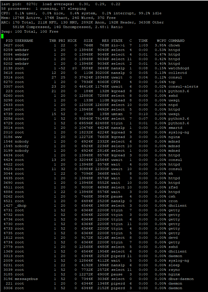

fr0stbyte
Apr 4, 2019
8
I started the backup job on 3 of the remote server and then took a ps and top:
SweetAndLow
Sweet'NASty
Nov 6, 2013
6,421
Well httpd is already using 8GB of memory. Seems like that could be the problem.

Well, I have held off on the bug report because shortly after I replied yesterday, the httpd memory usage had went back down. What it looks like is happening is when the backup job begins, it is doing a delta comparison. That comparison causes httpd to spike memory usage on the NAS. Once that delta comparison is complete, the backup job is transferring data. Long story short the NAS didn't become unresponsive last night. The only thing that I have done different was that I hadn't rebooted the NAS after the tuning changes previous nights. I did reboot it yesterday before creating this post. I have attached what the memory and ARC looked like last night. Is this normal for the scenario I explained above? My only tuning variable is vfs.zfs.arc_max=61776000000. Also the NAS dmesg was full of swap_pager_getswapspace failed this morning again, so I am guessing that means the NAS was killing off processes to try and regain swap?
The fact that memory increased and decreases shows it's not a memory leak. But that's almost worse because that means it's working the way it's designed. You should still file a bug and include your graphs. What backup application are you using? Can you do it over something other than webdav?
