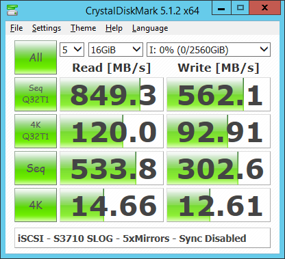

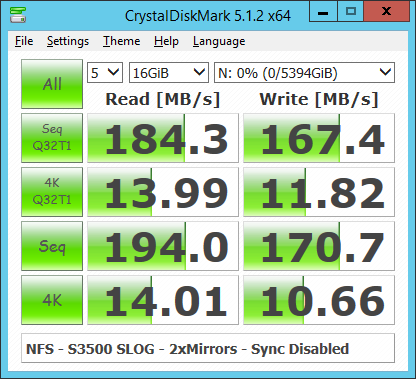

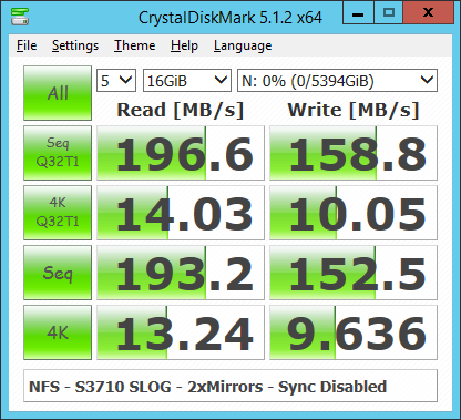

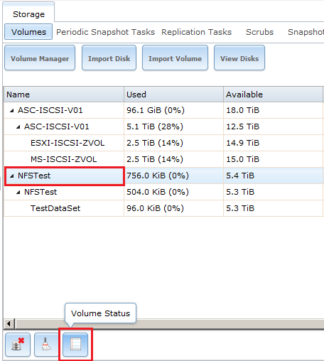

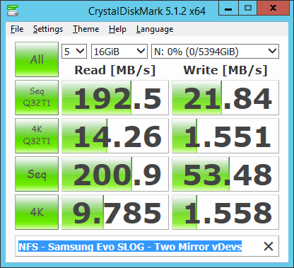

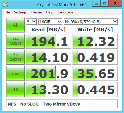

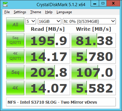

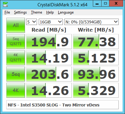

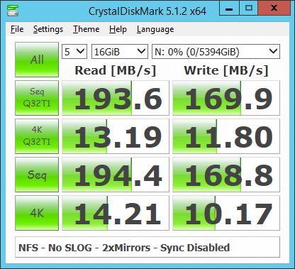

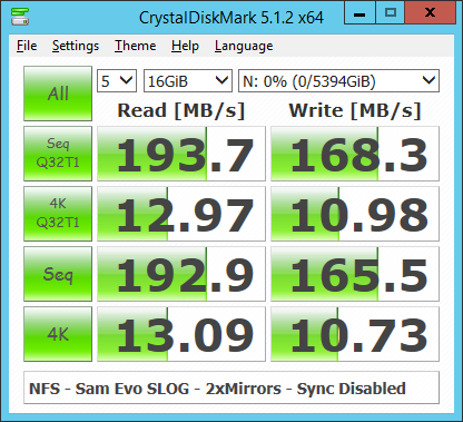

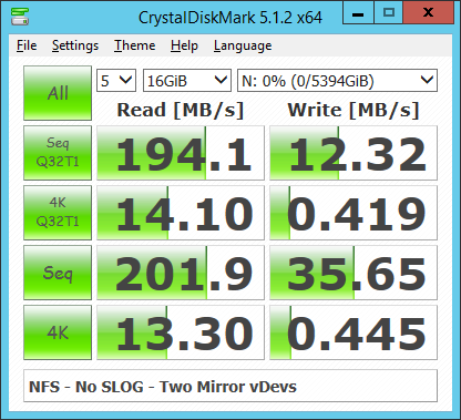

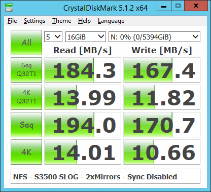

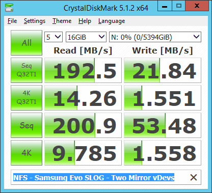

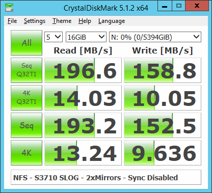

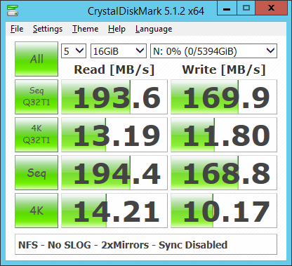

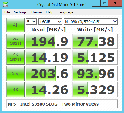

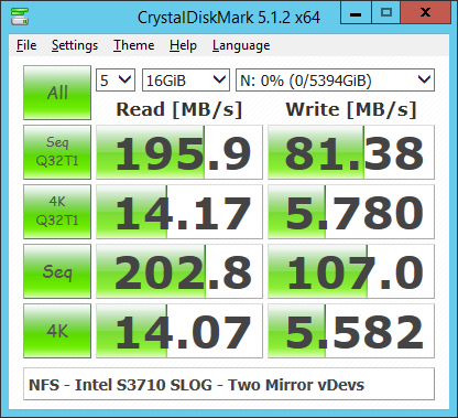

Here are some actual tests I did on a quickly created NFS Share (Shoutout to @Mlovelace for helping me get this working with Server 2o12 R2).
So, apologies in advance for the images but a picture is worth a thousand words..
All tests were done against a new Pool composed of 2 x 3TB Mirror vDevs. No additional NFS Tuning was done, just created, shared it and attached to it from Server 2012 R2 DataCenter machine.

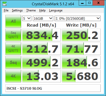

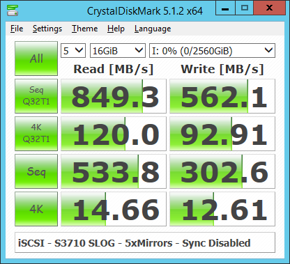

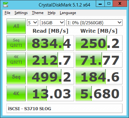

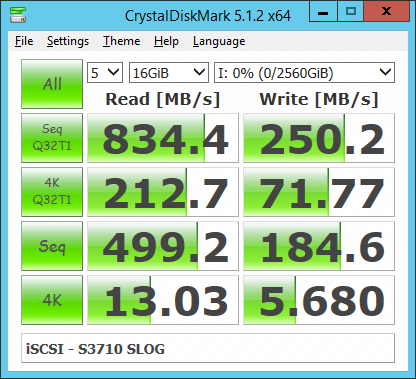

Just for a comparison, this is the iSCSI Pool (has 5 x 2TB Mirror vDevs) and an Intel S3710 200GB SLOG. I also have "sync=always":

Very clarifying test!
So always choose an Intel zil above Samsung when using nfs, but iscsi runs circles around nfs...
I'm all about Intel. There are plenty of threads on NFS vs iSCSI to make ones head spin. Keep in mind that there was no tuning on the NFS. I am not that adept in it and wanted to mainly provide "side by side" tests to show the SSD SLOG perspectives.
IMHO, iSCSI is still better though, but NFS does have its "Use-Case"; same with CIFS... Forget AFP as far as I am concerned... :)
The iSCSI result has more IOPS going for it with 5 Mirrors vs the 2 Mirrors used in the NFS testing. Certain restrictions pertain to iSCSI, like not going above 50% full, etc.
A blazing NVMe for a SLOG will definitely make those numbers get higher, but perhaps not so much on my old hardware... ;)

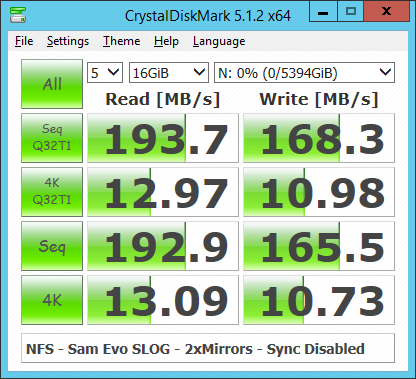

Awesome testing. Any chance you could add an NFS test with Sync Disabled?

The SLOG needs to have Power Loss Protection, or its not really a SLOG. The Samsung does not. You should have it replaced with an Intel SSD. The Intel SSDs generally have steady random write performance, high write endurance, and PLP.

Here are both for iSCSI. First one is with "sync=always"
Thanks for your extensive testing.
I am happy that you are seeing the same results as I am : iSCSI forced sync roughly cuts the write performance in half.
However you are getting overall higher speed values. I think I will exchange the Samsung 850 Pro ZIL SSD for an intel SSD.

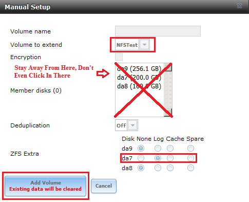

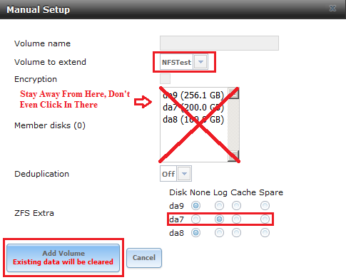

Everybody is sure that I can swap the ZIL without destroying the pool? What would be the step-by-step instructions for that?
Mirfster
Oct 2, 2015
3,215

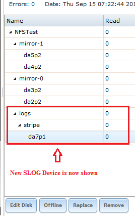

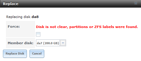

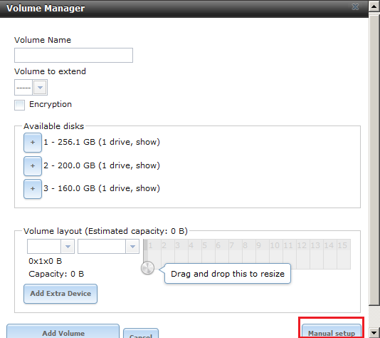

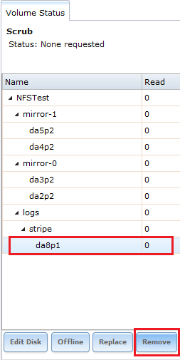

Been doing it the entire time through the testing. ;)

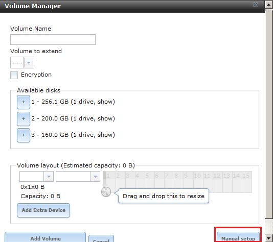

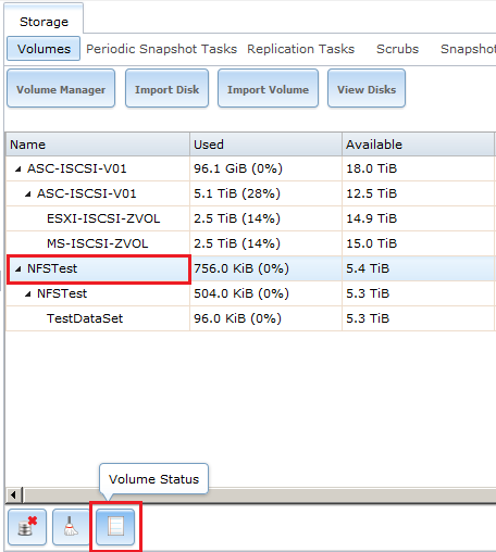

However, I have not been using [Replace], instead I completely [Remove] the Drive (in the GUI) and then add the new one using [Volume Manager] - [Manual Setup]. This way is a little more dangerous, since you for sure do not want to incorrectly have it added as a "Member Disk", but as a "ZFS Extra" instead.
The reason for this is that my disks are not clear and I would end up with a message similar to this if I used the [Replace] (Of course I could just whack the new drive first with gpart destroy /dev/%disk%, but too lazy)
Message I am avoiding by NOT using [Replace]:
So here is the way I am doing it:
With new SLOG now attached:
Great tutorial. I will follow it to the letter :smile:
