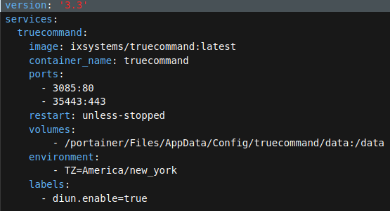

I'm unable to get the Docker container started in my enviornment.
Starting TrueCommand: Mon Dec 21 10:45:03 EST 2020
Starting Services [1/3]
Starting PostgreSQL 11 database server: main.
Starting Services [2/3]
nginx: [emerg] socket() [::]:80 failed (97: Address family not supported by protocol)
[ERROR] Could not start Nginx!
 - Finished: Mon Dec 21 10:45:05 EST 2020
Google tells me this is because NGINX is attempting to bind with IPV6. I do not have IPV6 enabled on the underlying host.

I loaded the up a VM with Debian 10.7, the latest version of docker and our Truecommand Docker image with ipv6 disabled on the host system and I was unable to recreate this issue. So I do not believe the configuration needs to be edited. Can you give me more specific of your specific setup? What OS and version are you running on the host? is this it he latest truecommand docker container you are trying to run? Is the Host system a fresh install?
freenasmww
Oct 11, 2016
4
I believe I am pulling the latest version.
cat truecommand.yml
version: "3.8"
services:
  truecommand:
    environment:
      - PUID=${PUID}
      - PGID=${PGID}
      - TZ=${TZ}
    volumes:
      - ${USERDIR}/docker/truecommand/data:/data
    ports:
      - 9490:80

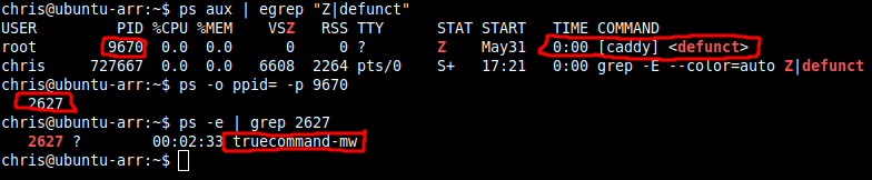

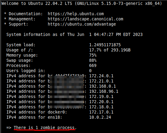

I have just moved my docker instance to a new VM and spun up Truecommand. I am getting zombie processes on that VM coming from truecommand-mw.
I don't recall seeing a zombie process for caddy and truecommand on my old Docker instance so I was wondering what I may have done wrong.
Here is my compose for a custom template in Portainer. It's the same code I have used for the past 2 years, I just changed it from V1.2 to latest on the image tag about 8 months or so ago when I noticed I wasn't getting the new version update.
