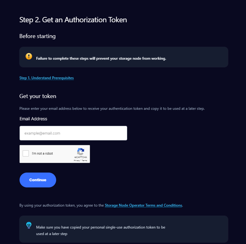

Obtaining an Authentication Token for Storj
Open a browser window and go to Storj Get an Authorization Token. Enter an email address, select I’m not a robot, then click Continue.
Storj Host a Node
Figure 1: Storj Host a Node
Copy the auth token to use later in this procedure. Keep the token in a secure location.

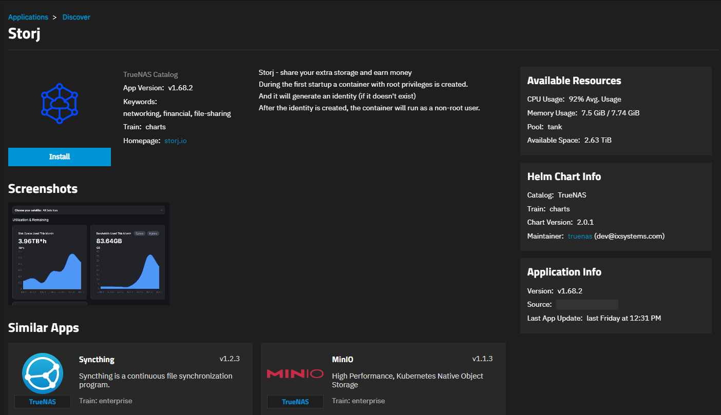

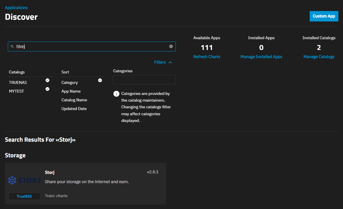

Go to Apps, click on Discover Apps. Either scroll down to the Storj application or begin typing Storj into the search field to locate the widget.
Locate Storj App Widget
Figure 4: Locate Storj App Widget
Click on the widget to open the Storj information screen.
Storj App Information Screen
Figure 5: Storj App Information Screen

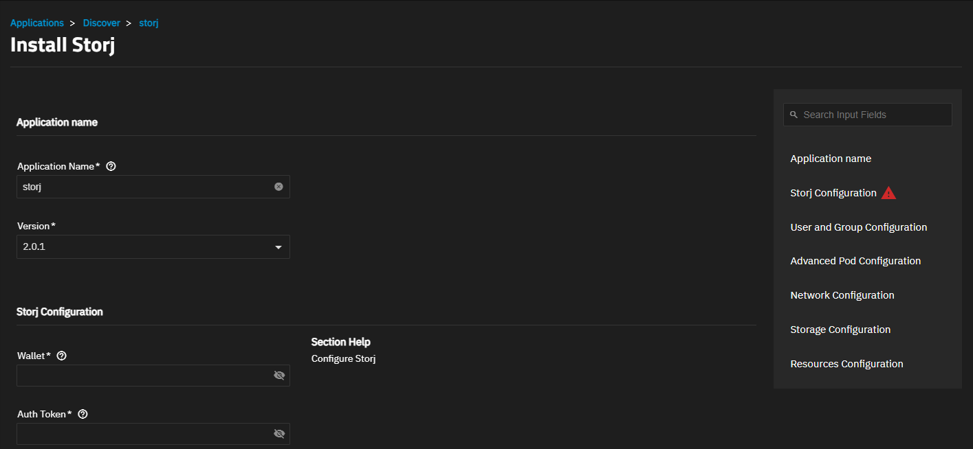

Click Install to open the Install Storj app configuration wizard.
Install TrueNAS Storj App
Figure 6: Install TrueNAS Storj App
Scroll down to each section or click the navigation menu item on the right of the screen to jump to that section.
Accept the default name or enter a new name for your Storj application if you prefer. Enter a name that consists of, and begins or ends with lowercase alphanumeric characters. Do not use a hyphen as the first or last character. For example, storjnode, or storj-node, but not -storjnode or storjnode-.
Do not change the Version. TrueNAS alerts you when a new version is available for deployed apps, and allows you to update through the click of a button on the Installed application screen.

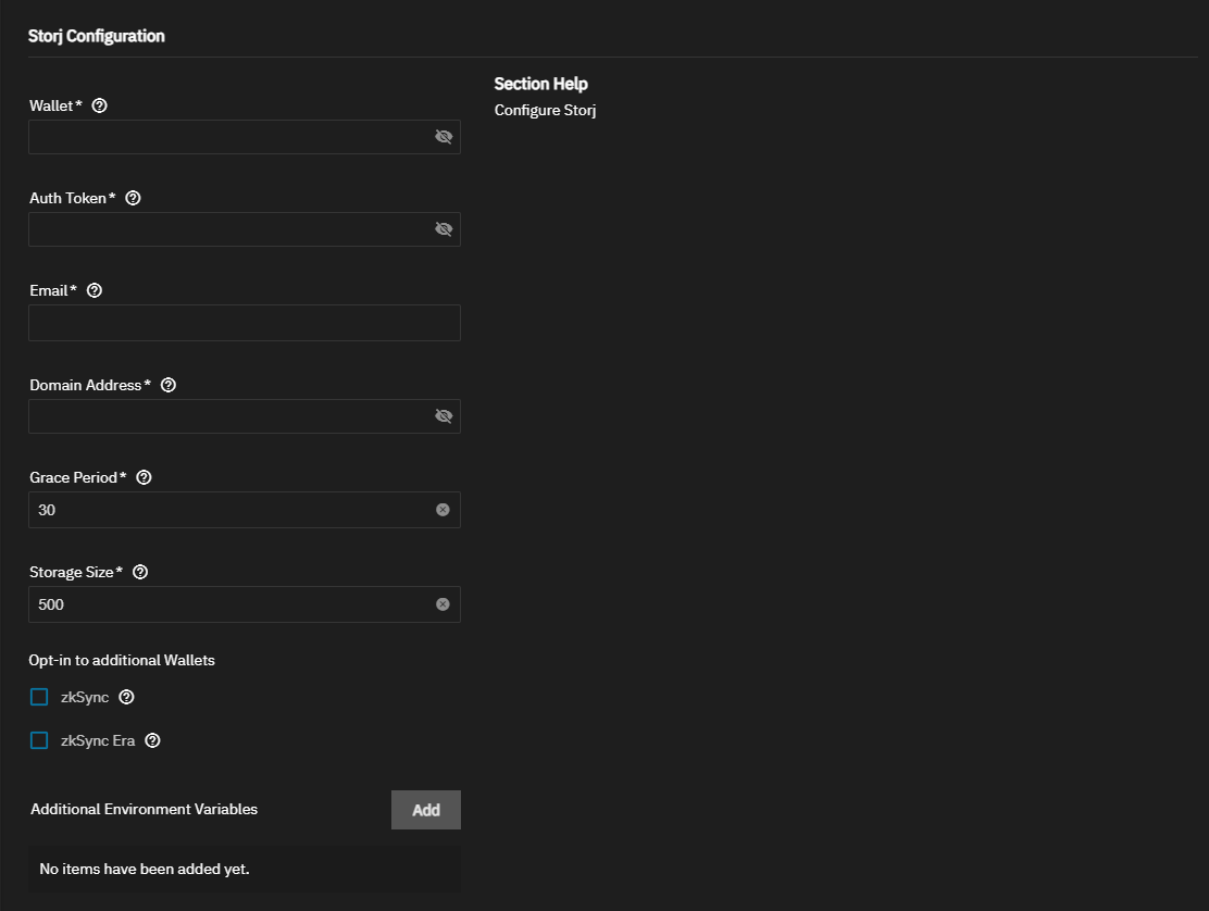

  1. Enter the Storj Configuration settings:
    a. Enter the wallet address in Wallet in the Storj Configuration section.
    Select either zkSync or zkSync Era or both if you want to uses these wallet optional flags.
    b. Enter the authentication token copied from Storj in Auth Token.
    c. Enter the email address used when you obtained the token in Email.
    d. Enter the storage domain (i.e., the public network DNS name) added for Storj in Domain Address. If using Dynamic DNS (DDNS), enter that name here as well. For example, name.ddns.net.
    e. Accept the default values for Grace Period and Storage Size unless you want to set different parameters for the rented storage.
    f. Click Add to show Additional Environmental Variables fields. These are optional settings. The Install Storj wizard includes all required settings to deploy the Storj node application.

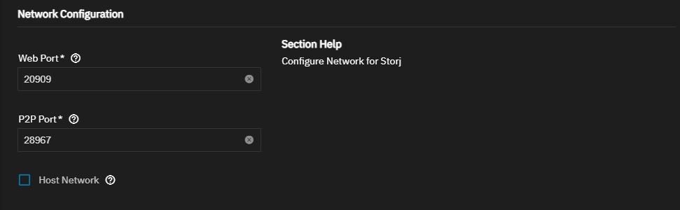

  3. Accept the default values in the Advanced Pod Settings section unless you want to use advanced DNS configuration settings. Accept the default ports in Network Configuration.
  4. Accept the default Network Configuration settings. If you want to use different ports, check the default port list for a list of available or unavailable port numbers. Leave Host Network unselected.

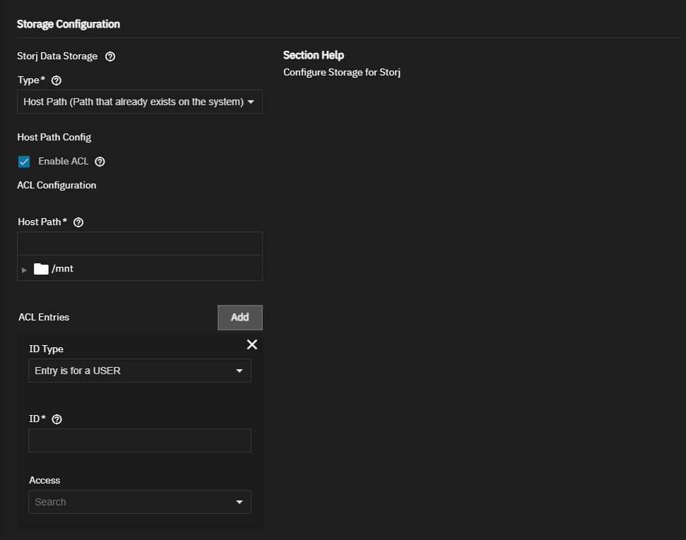

  5. Configure the Storage Configuration settings. You can use the default ixVolume option to allow TrueNAS to create the data storage volume or select Host Path to select the path to the new data dataset created earlier in this document.
    To modify the dataset permissions, select Enable ACL to show the option to create an ACL entry to customize the dataset permissions.
    The data dataset does not require execute permissions, just read and write. If you add an ACE (ACL entry) for this dataset, you do not need to grant execute permissions for the user added for this dataset.
    Repeat this for the identity dataset. Select Host Path in the Storj Identity Storage > Type field then enter or browse to select the mount path for the existing dataset.
