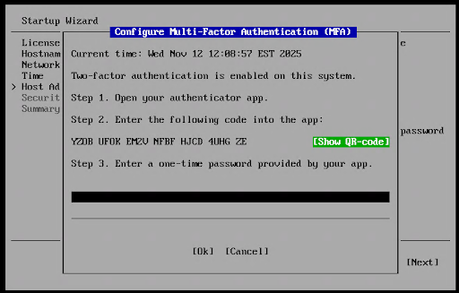

Set the default veeamadmin password. This password must meet DISA STIG guidelines for passwords.
Veeam also requires enabling Multi-Factor Authentication (MFA) using an authenticator app. Follow the on-screen instructions to configure MFA.

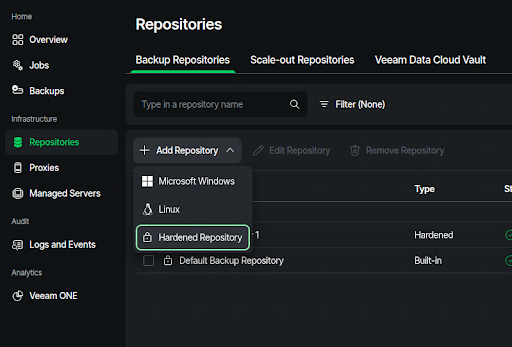

Go to the Repositories menu and click Add Repository > Hardened Repository.
