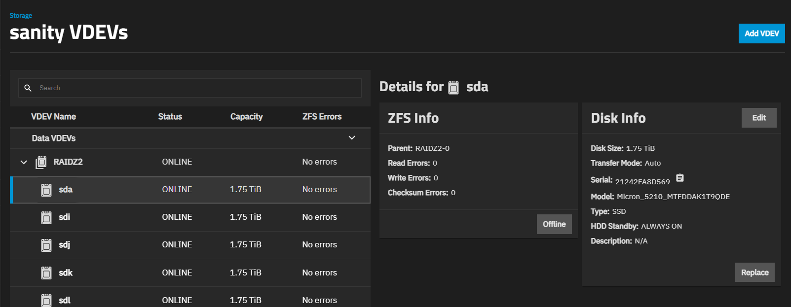

Disk Cards
Each disk in a VDEV has two cards that show information for that disk: ZFS Info and Disk Info. After selecting a disk, the cards show on the right side of the screen in the Details for diskname area of the screen.

ZFS Info Card
The ZFS Info card for each device (disk drive) in the VDEV shows the name of the VDEV (Parent), the read, write, and checksum errors for that drive, and the Detach and Offline options.
Detach opens a confirmation dialog and removes the selected drive from the parent VDEV.

Offline opens a confirmation dialog and takes the selected drive to an offline state before taking a disk offline to replace it. Toggles to Online so you can bring a replacement disk online. After taking a drive offline, you can remove or replace the physical drive.

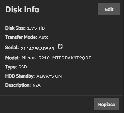

Disk Info Card
The Disk Info card shows the disk size, transfer mode, the serial and model numbers for the drive, type of drive, HDD standby setting, and a description associated with the selected drive.
Disk Info Card
Figure 8: Disk Info Card
Replace opens the Replacing disk diskname dialog, where diskname is the name of the selected disk.

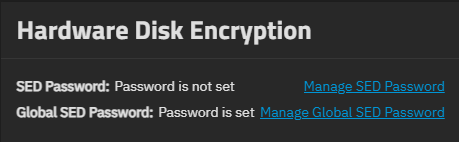

Hardware Disk Encryption Card
TrueNAS Enterprise
The Hardware Disk Encryption card only shows on Enterprise systems with an SED license and with SED drives.
The Hardware Disk Encryption card shows drive information, like whether the SED password is set or not. It might show on non-enterprise systems with self-encrypting drives, but not all configuration options show in the UI. Community users should use the SED utilities to manage these drives.
The Manage SED Password link opens a Manage SED Password dialog, where you can enter a disk SED password to set the disk encryption password.
Figure 9: Hardware Disk Encryption Card
Manage Disk SED Encryption Password
Figure 10: Manage Disk SED Encryption Password
Global SED Password shows the status as set or not set. The Manage Global SED Password link opens the System Settings > Advanced screen, where you can change the global SED password that overrides the disk passwords.
