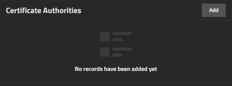

The Certificate Authorities widget on the Credentials > Certificates screen displays certificate authorities(CAs) added to SCALE, and allows you to add new CAs, or download, delete, or edit the name of an existing CA.
CertificateAuthoritiesWidgetNoCAs
The download icon downloads the CA to your server.
delete deletes the CA from your server.
Each CA listed on the widget is a link that opens the Edit CA screen.
Add opens the Add CA wizard that steps you through setting up a certificate authority (CA) that certifies the ownership of a public key by the named subject of the certificate.

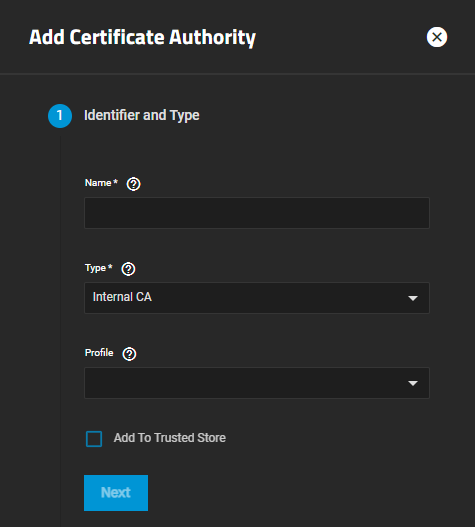

Identifier and Type Options
The Identifier and Type options specify the CA name and choose whether to create a new CA or import an existing CA.
Users can also select a predefined certificate extension from the Profiles dropdown list.
The selection in Type changes setting options on this screen, the Certificate Options and Extra Constraints screens, and determines if the Certificate Subject screen displays at all.
AddCAIdentifierAndType
SettingDescription
NameRequired. Enter a descriptive identifier for this certificate authority(CA).
TypeSelect the type of CA from the dropdown list. Options are Internal CA, Intermediate CA, and Import CA. Internal CA functions like a publicly trusted CA to sign certificates for an internal network. They are not trusted outside the private network. Intermediate CA lives between the root and end entity certificates and its main purpose is to define and authorize the types of certificates you can request from the root CA. Import CA allows you to import an existing CA onto the system. For more information see What are Subordinate CAs and Why Would You Want Your Own?.
ProfilesDisplays if Internal CA or Intermediate CA are set in Type. Select a predefined certificate extension from the dropdown list. Choose a profile that best matches your certificate usage scenario. Options are Openvpn Root CA and CA.

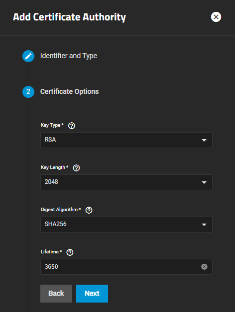

Certificate Options
The Certificate Options settings specify the type of private key to use (as well as the number of bits in the key used by the cryptographic algorithm), the cryptographic algorithm the CA uses, and how many days the CA lasts.
The Certificate Options settings do not display if Type on the Identifier and Type screen is set to Import CA.
The Key Type selection changes fields displayed. RSA is the default setting in Key Type.
AddCACertificateOptionsRSAType
SettingDescription
Key TypeSelect the key type from the dropdown list. Options are RSA or EC. RSA displays the Key Length field. EC displays the EC Curve field. See Why is elliptic curve cryptography not widely used, compared to RSA? for more information about key types.
EC CurveDisplays when EC is selected in Key Type. Select the curve type from the dropdown list. Options are BrainpoolP512R1, BrainpoolP384R1, BrainpoolP256R1, SECP256K1, SECP384R1, SECP521R1, and ed25519. Brainpool curves can be more secure while SECP curves can be faster. See Elliptic Curve performance: NIST vs Brainpool for more information.
Key LengthRequired. Displays when RSA is selected in Key Type. Select the number of bits in the key used by the cryptographic algorithm from the dropdown list. Options are 1024, 2048 or 4096. For security reasons, a minimum key length of 2048 is recommended.
Digest AlgorithmSelect the cryptographic algorithm to use from the dropdown list.Options are SHA1, SHA224, SHA256, SHA384 and SHA512. Only change the default SHA256 if the organization requires a different algorithm.
LifetimeEnter the number of days for the lifetime of the CA.

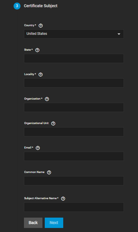

Certificate Subject Options
The Certificate Subject settings define the location, name, and email for the organization using the certificate.
Users can also enter the system fully-qualified hostname (FQDN) and any additional domains for multi-domain support.
The Certificate Subject settings do not display if Type on the Identifier and Type screen is set to Import CA.
AddCACertificateSubject
SettingDescription
CountryRequired. Select the country of the organization from the dropdown list.
StateRequired. Enter the state or province of the organization.
LocalityRequired. Enter the location of the organization. For example, the city.
OrganizationRequired. Enter the name of the company or organization.
Organizational UnitEnter the organizational unit of the entity.
EmailRequired. Enter the email address of the person responsible for the CA.
Common NameEnter the fully qualified host name (FQHN) of the system. This name must be unique within a certificate chain.
Subject Alternate NamesRequired. Enter additional domains to secure for multi-domain support. Separate each domain by pressing Enter. For example, if the primary domain is example.com, entering www.example.com secures both addresses.

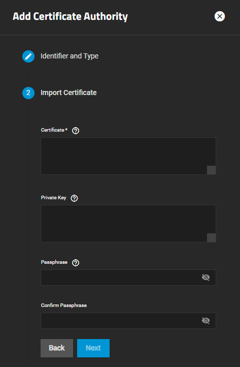

Extra Constraints - Import CA
When Type on Identifier and Type is set to Import CA the Extra Constraints screen does not include the options to set extension types.
AddCAExtraConstraintsImportCA
SettingDescription
CertificateRequired. Paste the certificate for the CA into this field.
Private KeyRequired. Paste the private key associated with the certificate when available. Provide a key at least 1024 bits long.
PassphraseEnter the passphrase for the private key.
Confirm PassphraseRe-enter the passphrase for the private key.

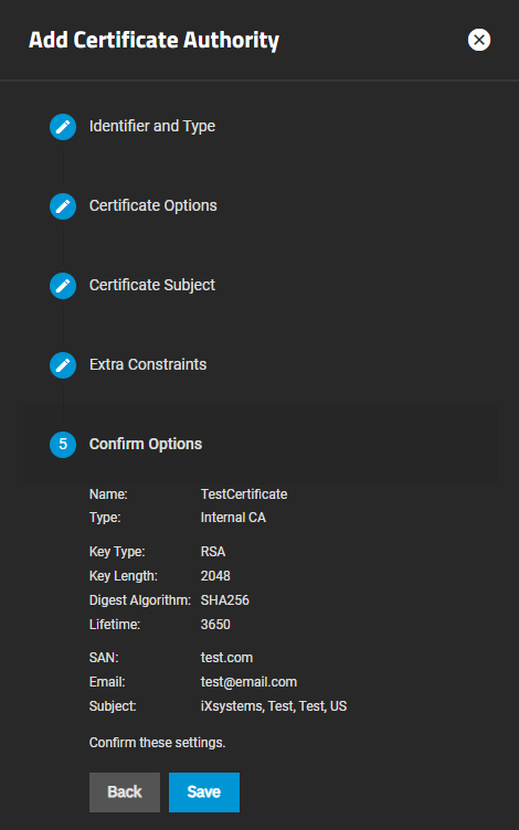

Confirm Options
The final step screen is the Confirm Options that displays the CA Type, Key Type, Key Length, Digest Algorithm, Lifetime, Country, and any configured Usages. For Import CA type, the screen displays Type and Certificate.
AddCAConfirmOptions
Save adds the certificate to SCALE. Back returns to previous screens to make changes before you save. Next advances to the next screen in the sequence to return to Confirm Options.
