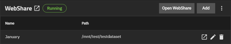

The WebShare widget displays Open WebShare and Add buttons, and a more_vert icon for accessing service options. Each configured WebShare displays as a row showing the share name, path, and action icons to open the share in a new browser tab, edit the share, or delete the share.

WebShare Widget
Figure 1: WebShare Widget
  1. Go to Shares and locate the WebShare widget.
  2. Click the more_vert icon and select Config Service.

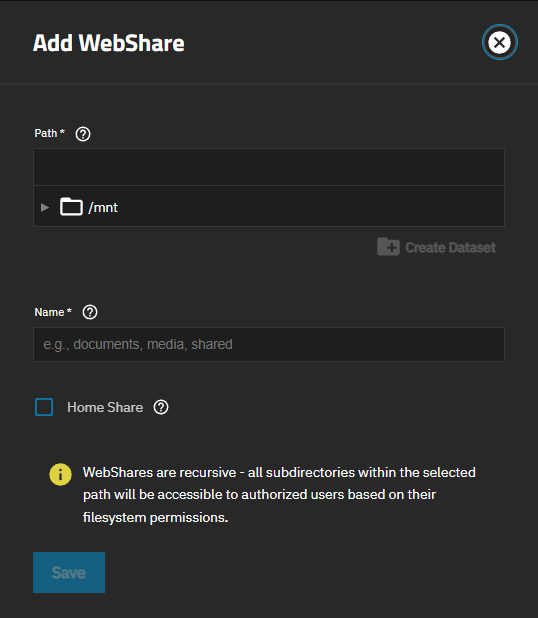

  2. Click Add.
  3. Select the Path to the directory you want to share. The path must be under /mnt/poolname/. All subdirectories within the selected path are accessible to authorized users based on their file system permissions.
  4. Enter a Name for the WebShare. The name must contain only letters, numbers, hyphens, and underscores.
  5. (Optional) Select Home Share to use this share as the base path for user home directories. Only one WebShare can have this option enabled.
  6. Click Save.

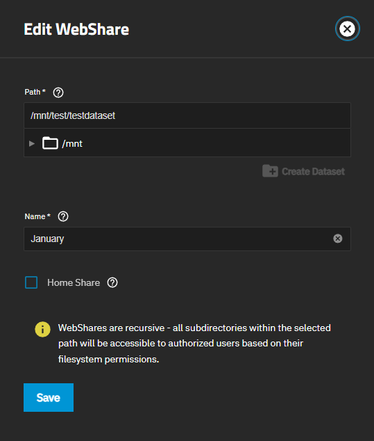

Editing a WebShare
To modify an existing WebShare, click the edit icon on the share row. The Edit WebShare screen allows you to change the path, name, and home share setting.
Edit WebShare
Figure 3: Edit WebShare

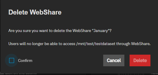

Deleting a WebShare
To delete a WebShare, click the delete icon on the share row. A confirmation dialog displays before the WebShare is removed.
Delete WebShare Dialog
Figure 4: Delete WebShare Dialog

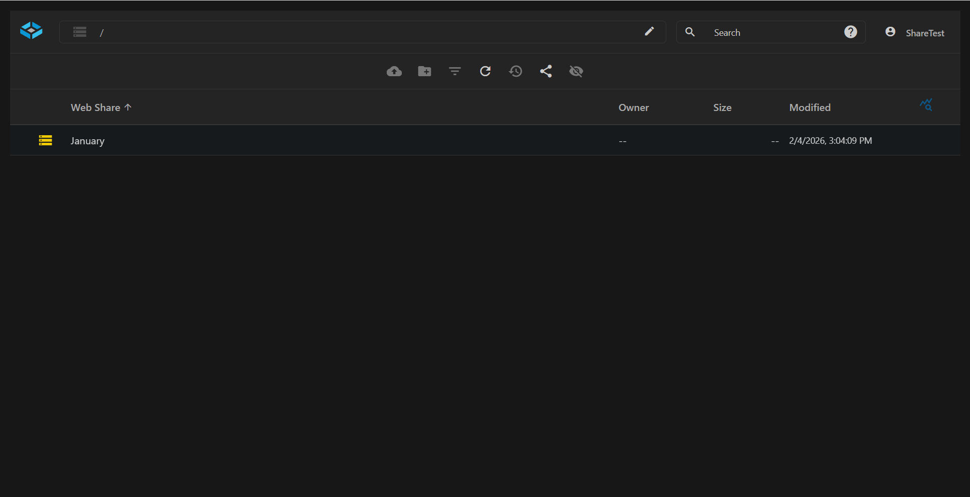

Accessing WebShare
After configuring the service, creating a share, and enabling user access:
  1. Click Open WebShare on the WebShare widget in the Shares dashboard. Alternatively, access WebShare directly using your TrueNAS Connect URL on port 755.
  2. Log in with the credentials for a TrueNAS user account that has WebShare Access enabled.
  3. Navigate to the share to browse files.
WebShare UI Home
Figure 5: WebShare UI Home
Using WebShare
The WebShare interface provides a file browser with toolbar buttons for common actions.
The file list displays columns for file name, owner, size, and modified date. Click a folder to open it. Click the arrow_back icon in the column header to navigate to the parent directory. Click the Name column header to sort files alphabetically.
