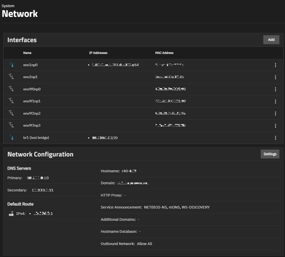

  3. Go to System > Network and take a screenshot showing your Interfaces and the Global Configuration widgets.

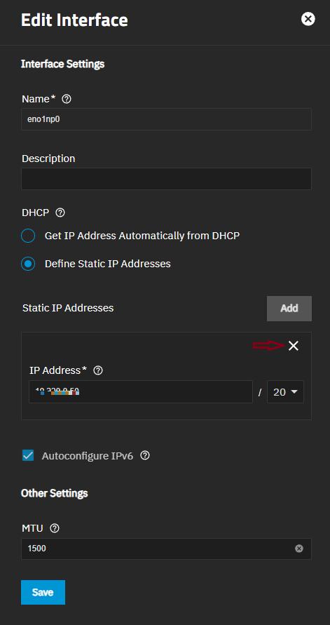

  4. Click the more_vert icon for the interface, to open the Edit Interface screen. Click the x to the right of Static IP Addresses to remove the current static IP address assignment, and then click Save.

    TrueNAS shows the bridge on the Interfaces widget.
  6. Click Test Changes. See Testing Network Changes above for details on testing and saving network changes.
TrueNAS shows the bridge as working.
