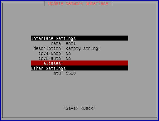

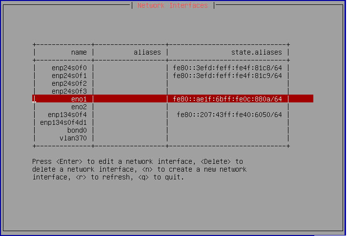

  1. Type 1 and then press Enter to open the Network Interfaces screen.
  2. Use either Tab or the arrow keys to select the interface assigned as your primary network interface. If you have more than one interface installed and wired to your network, the primary interface is typically eno1. With the interface highlighted, press Enter to open the Update Network Interface screen.
  3. Tab or arrow down to ipv4_dhcp and change it to no.
  4. Tab or arrow down to the aliases setting and enter the static IP address for controller 1. Tab or arrow down to Save, and then press Enter. A pending network changes notice displays with additional options.
  5. Type a to apply the change, then p to make it persist. Type q to return to the main Console setup menu.

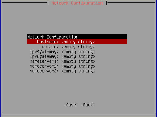

  6. Type 2 and then press Enter to open the Network Configuration screen.
  7. Use either Tab or the arrow keys to select each field. Type the value for each field listed below. Press Enter after each value.
    FieldDescription/Example
    hostnameThe host name you assign to controller 1. For example m50-123-1.
    domainThe domain name for the nework controller 1. For example my.companyname.net
    ipv4gatewayThe default gateway IP address for your network.
    nameserver1
    nameserver2
    The IP addresses for your network DNS servers.
  8. Use either Tab or the arrow keys to select Save, then type q to return to the main Console setup menu.

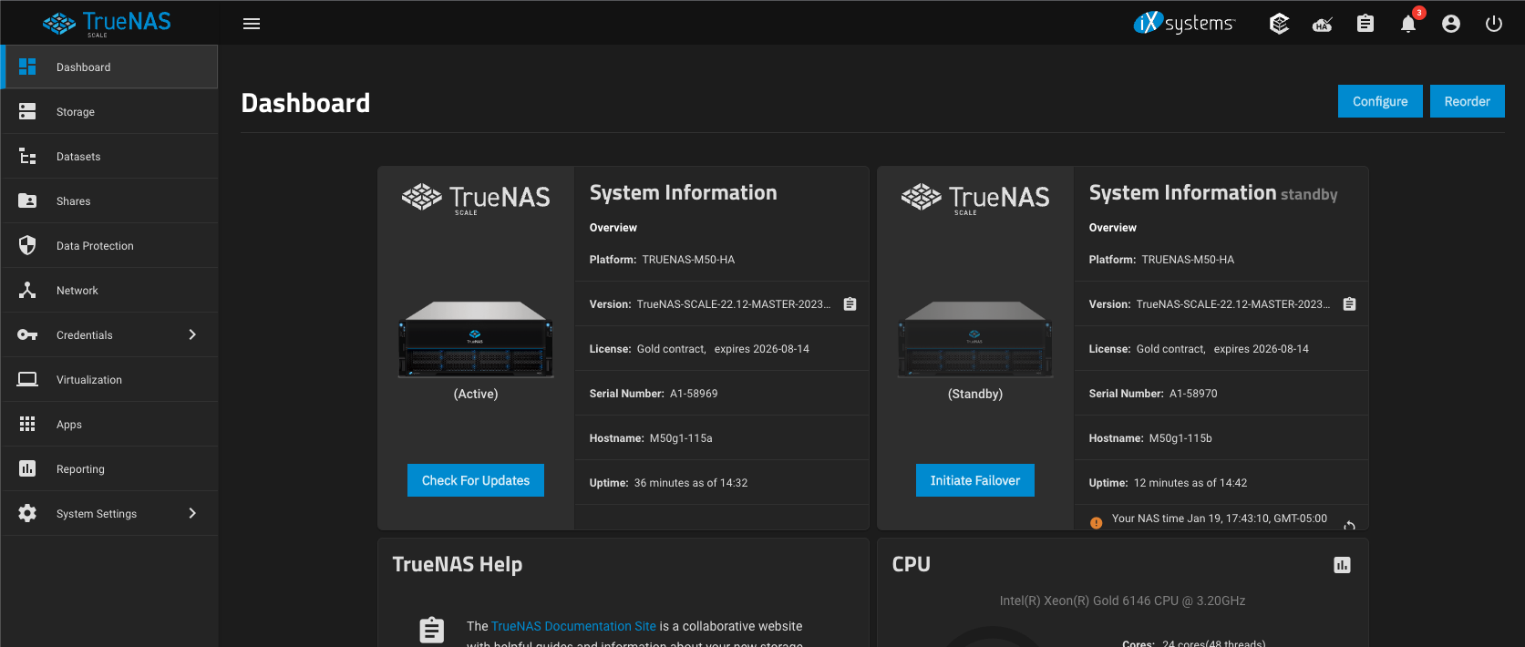

TrueNAS UI Enterprise customers see the End User License Agreement (EULA) screen the first time they log in. Sign the agreement to open the main TrueNAS Dashboard. Apply the system license next.
Go to System > General Settings and click Add License on the Support widget. Copy your license and paste it into the License field, then click Save License. The Reload dialog opens. Click Reload Now. Controller 1 restarts, and displays the EULA for controller 2. Sign the EULA agreement for controller 2, and add the license.
The controller 1 and 2 (or a and b) serial numbers display on the Support widget on the System > General Settings screen.

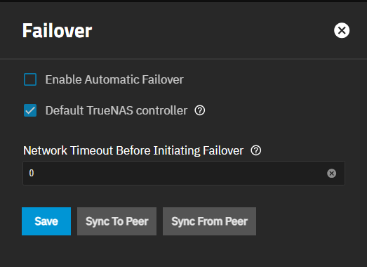

To configure network settings on controller 1:

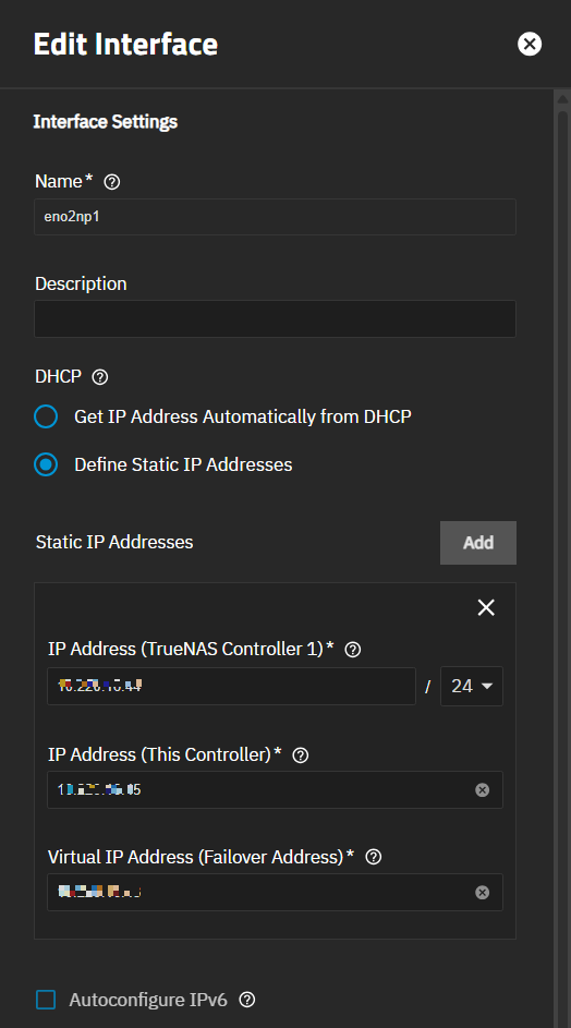

  1. Disable the failover service. Go to System > Advanced Settings, scroll down to the Failover widget, then click Configure. Select Enable Automatic Failover to clear the checkmark, then select Default TruNAS Controller to enable it, and then click Save to disable failover.
  2. Go to System > Network and click Settings to edit the global network settings. Add the controller and virtual host names and update any other network settings.

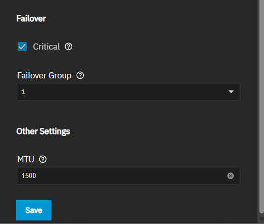

  3. Edit the primary network interface to add failover settings. Click on the more_vert to the right of the the primary interface eno1, and select Edit to open the Edit Interface screen for this interface.
    a. Turn DHCP off if it is on by selecting Define Static Ip Addresses. Click Add to show IP address fields for each interface. Enter the IP address assigned to controller 1 in IP Address (TrueNAS Controller 1), the IP address assigned to controller 2 in IP Address (This Controller), and the IP address assigned as the virtual IP in Virtual IP Address (Failover Address).
    If Define Static IP Addresses is already selected, verify the three static IP addresses assigned to the system show in the correct fields. First, enter the IP address for controller 1 into IP Address (This Controller) and select the netmask (CIDR) number from the dropdown list. Next, enter the controller 2 IP address into IP Address (TrueNAS Controller 2). Finally, enter the VIP address into Virtual IP Address (Failover Address).
    b. Add the failover settings. Select 1 on the Failover Group dropdown list.
  4. Click Save
  5. Click Test Changes after editing the interface settings. Open a new browser window and enter the VIP IP address to access the web UI. Go to System > Network and click Save Changes to make the changes permanent. You have 60 seconds to test and then save changes before they revert. If this occurs, edit the interface again.
  6. Enable failover. Go to System > Advanced Settings, scroll down to the Failover widget, then click Configure. Select Enable Automatic Failover to re-enable failover, then click save.

  4. Sync controller 1 and 2. With controller 2 powered on, but not configured, from controller 1 click Sync To Peer. Select Reboot standby TrueNAS controller and Confirm, then click Proceed to start the sync operation. This sync controller 2 with controller 1 which adds the network settings and pool to controller 2.
When the system comes back up, log into TrueNAS using the virtual IP address. The main Dashboard displays two System Information widgets. In standard configurations by iXsystems, Controller 1 shows its serial number and a host name that includes the letter a. Controller 2 is labeled as Standby Controller and shows its serial number and a host name that includes the letter b. Take note of this information.
Main Dashboard for HA Systems
Figure 15: Main Dashboard for HA Systems

The failover feature on TrueNAS Enterprise platforms with High Availability (HA) can malfunction in network environments that heavily use the Spanning Tree Protocol (STP). When configuring or troubleshooting HA failover, if TrueNAS HA failover does not function properly, investigate STP use in the network and consider disabling STP on network switch ports connected to the TrueNAS platform.
If controller 2 comes online as the primary and controller 1 as the standby, you installed and configured the controllers incorrectly.
  1. Go to System > Failover, clear the Default TrueNAS Controller option, and click Save. The system restarts and fails over to the current standby controller (in this case, to controller 1).
  2. Log back into the UI with the VIP address. Go to System > Failover and select Default TrueNAS Controller to make controller 1 the primary controller.
  3. Select Sync to Peer. TrueNAS makes controller 2 the standby controller and syncs the configuration on controller 1 to controller
  4. Click Save.
