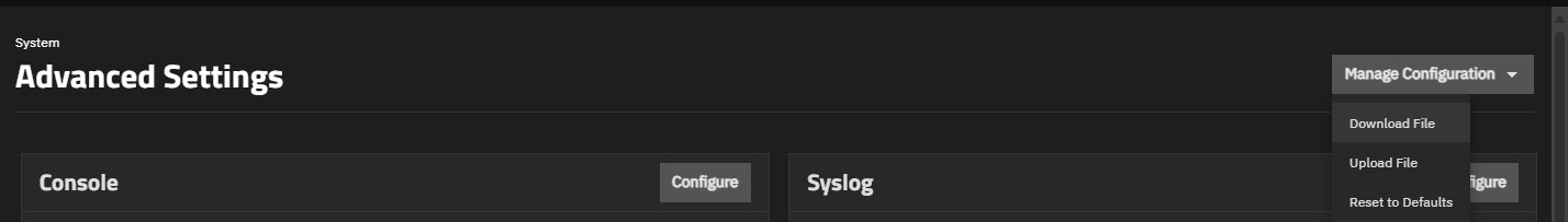

To download the configuration file:
Go to System > Advanced Settings and click on Manage Configuration. Select Download File.
The Save Configuration dialog opens.
Select Export Password Secret Seed and then click Save. The system downloads the system configuration. Keep this file in a safe location on your network where files are regularly backed up.
