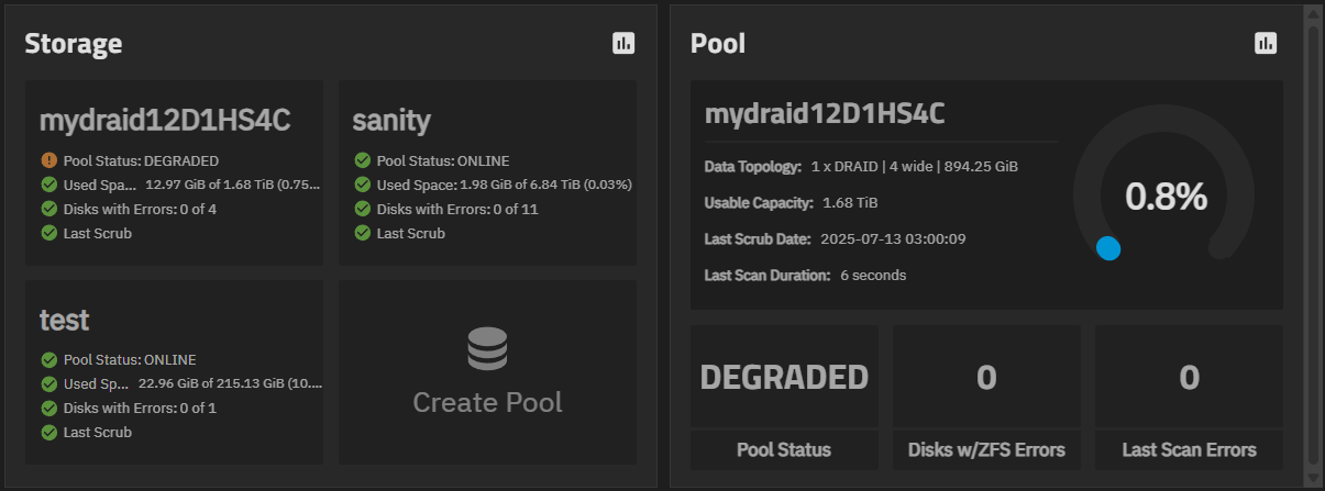

If you configure your main TrueNAS Dashboard to include an individual Pool or the Storage widgets, they show the status of your system pools as on or offline, degraded, or in an error condition.
Main Dashboard Pool and Storage Widgets Degraded

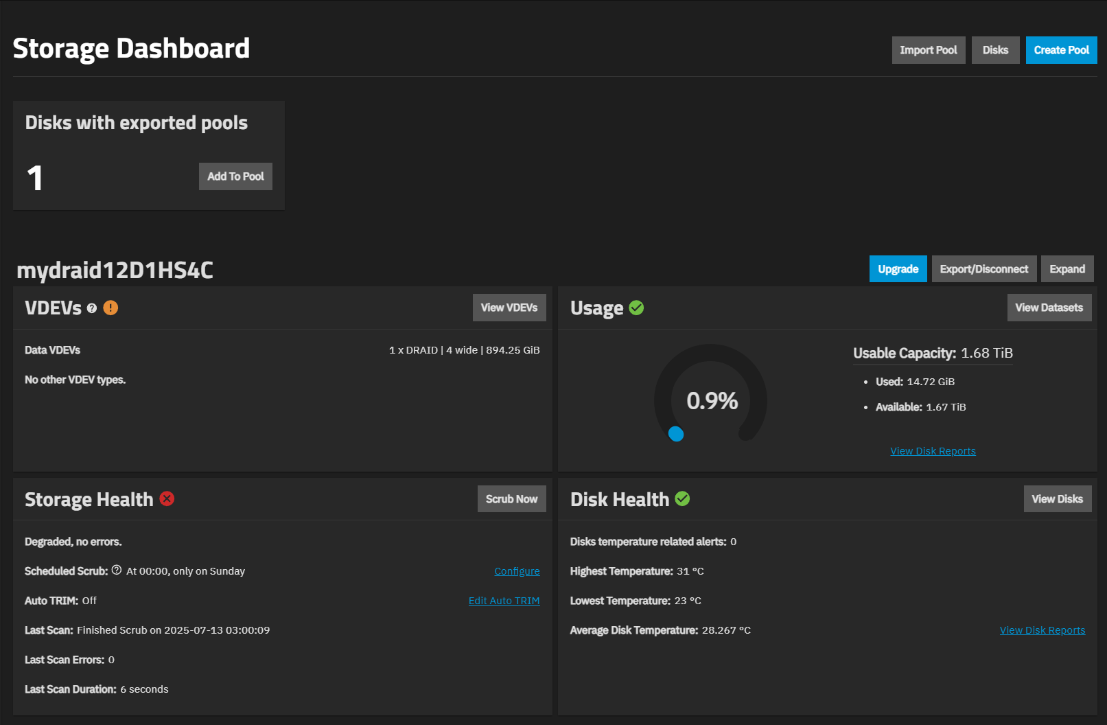

The Storage Dashboard pool widgets also show the status of each of your pools.
Storage Pool Widgets in Degraded State
Figure 2: Storage Pool Widgets in Degraded State
From the main Dashboard, you can click the on either the Pool or Storage widget or you can click Storage on the main navigation menu to open the Storage Dashboard screen and locate the pool in the degraded state.

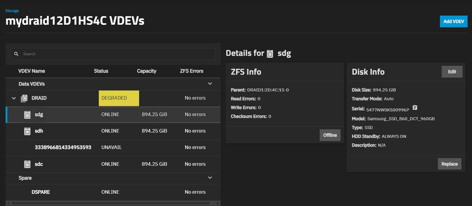

Go to the Storage Dashboard and click View VDEVs on the VDEVs widget for the degraded pool to open the VDEVs screen for that pool. Click next expand the VDEV, then look for the disk with the REMOVED status.
Devices Disk Failed
Figure 3: Devices Disk Failed
Click on the failed disk, then click Offline in the ZFS Info widget to take the disk offline. The disk status changes to OFFLINE.

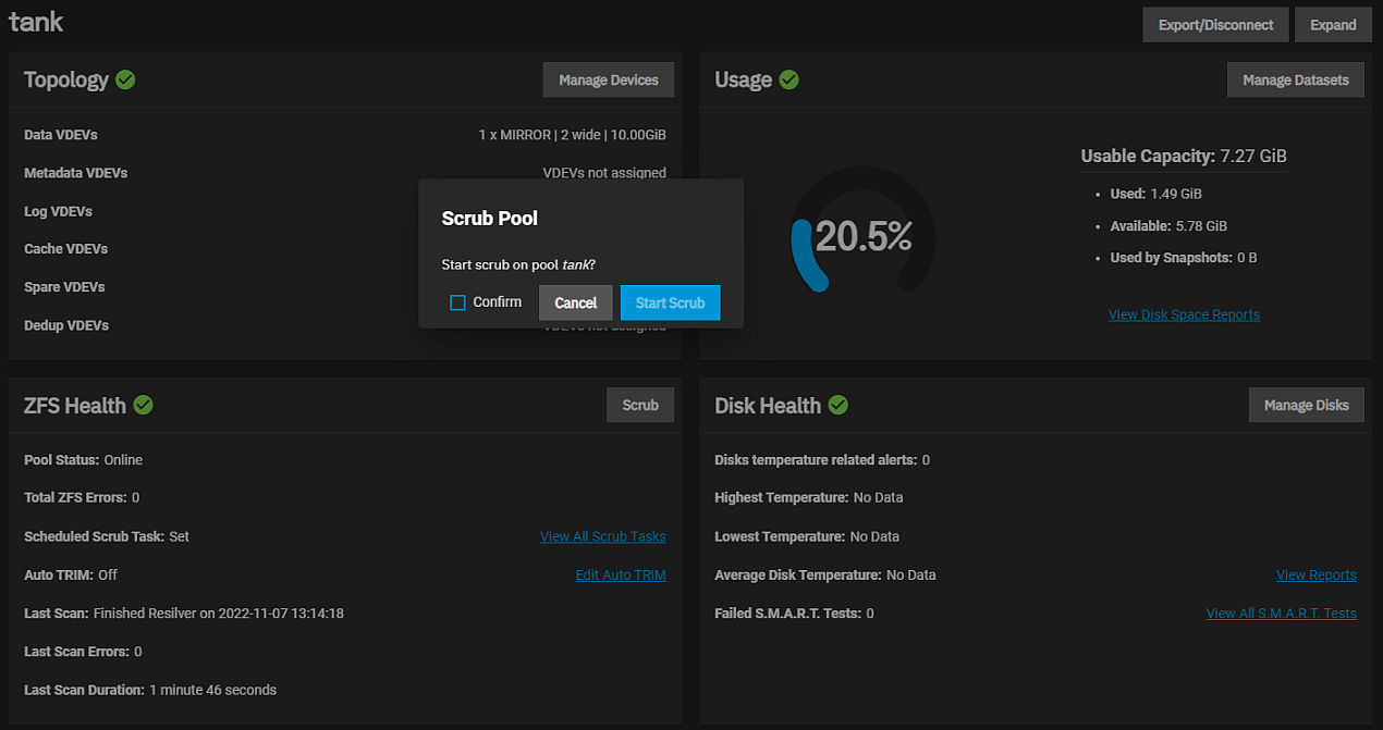

If the off-line operation fails with a Disk offline failed - no valid replicas message, go to Storage Dashboard and click Scrub on the ZFS Health widget for the pool with the degraded disk. The Scrub Pool confirmation dialog opens. Select Confirm and then click Start Scrub.
When the scrub operation finishes, return to the VDEVs screen, expand the VDEV, then click the disk, and try to offline it again.

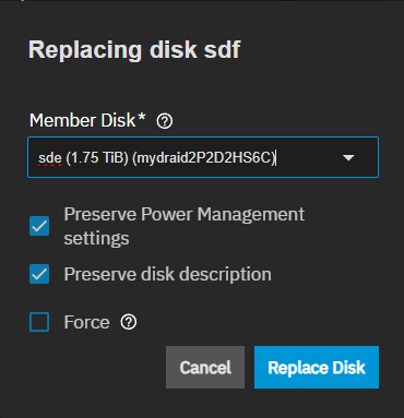

Click Replace on the Disk Info widget on the Devices screen for the disk you off-lined.
Select the new drive from the Member Disk dropdown list on the Replacing disk dialog.
Replacing Disk Dialog
Figure 5: Replacing Disk Dialog
Force overrides the safety check and adds the disk to the pool. Selecting this option erases any data stored on the disk!
Preserve disk description maintains any descriptions associated with the original disk, which prevents you from needing to copy descriptors to the new disk manually. This option is enable by default. Select to clear the checkmark if you want the replacement disk to use descriptors that differ from those attached to the original disk.
Click Replace Disk to add the new disk to the VDEV and bring it online.
Disk replacement fails when the selected disk has partitions or data present. To destroy any data on the replacement disk and allow the replacement to continue, select the Force option.

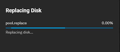

Replacing Disk Status
Figure 6: Replacing Disk Status
When the disk wipe completes, TrueNAS starts replacing the failed disk. TrueNAS resilvers the pool during the replacement process. For pools with large amounts of data, this can take a long time. When the resilver process completes, the pool status returns to Online on the Devices screen.

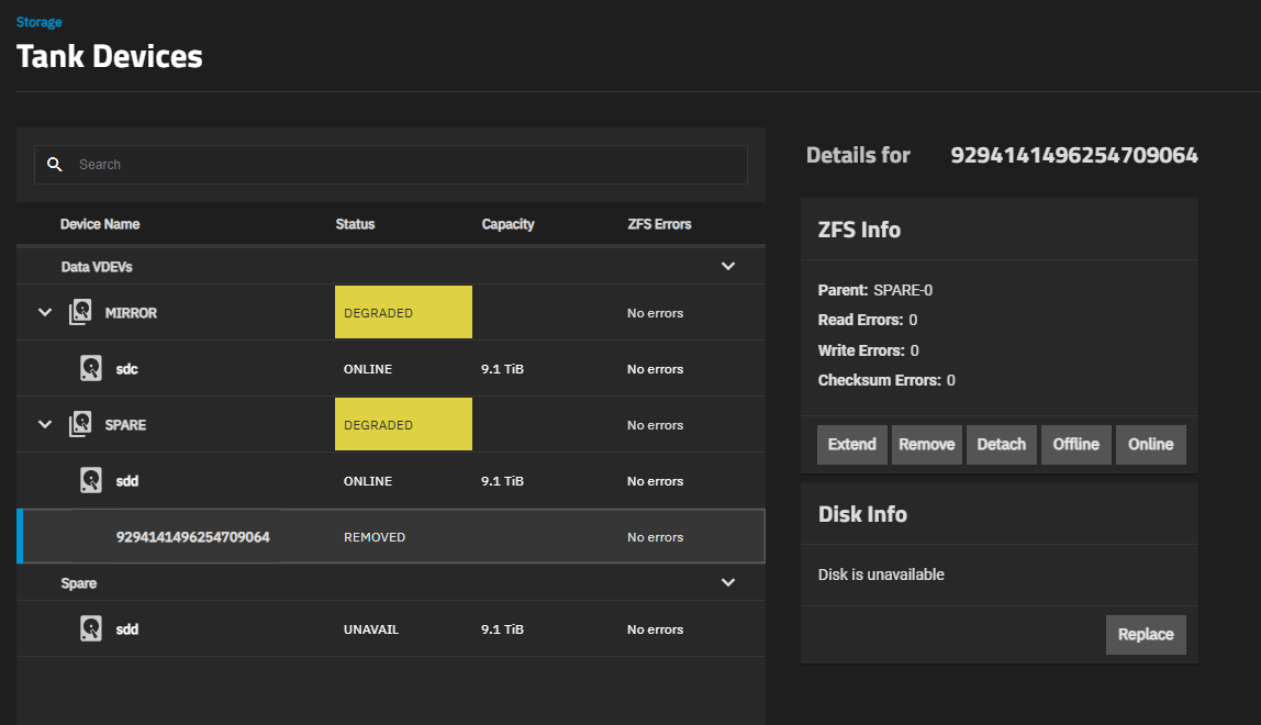

After taking the failed disk offline and physically removing it from the system, go to the Storage Dashboard and click View VDEVs on the VDEVs widget for the degraded pool to open the VDEVs screen for that pool. Click next to the VDEV to expand it, then look for the disk with the REMOVED status.
Devices Disk Failed - Hot Spare Active
Figure 7: Devices Disk Failed - Hot Spare Active
Click Detach on the ZFS Info widget on the VDEVs screen for the disk you off-lined.
Select Confirm, then click Detach. TrueNAS detaches the disk from the pool and promotes the hot spare disk to a full member of the pool.

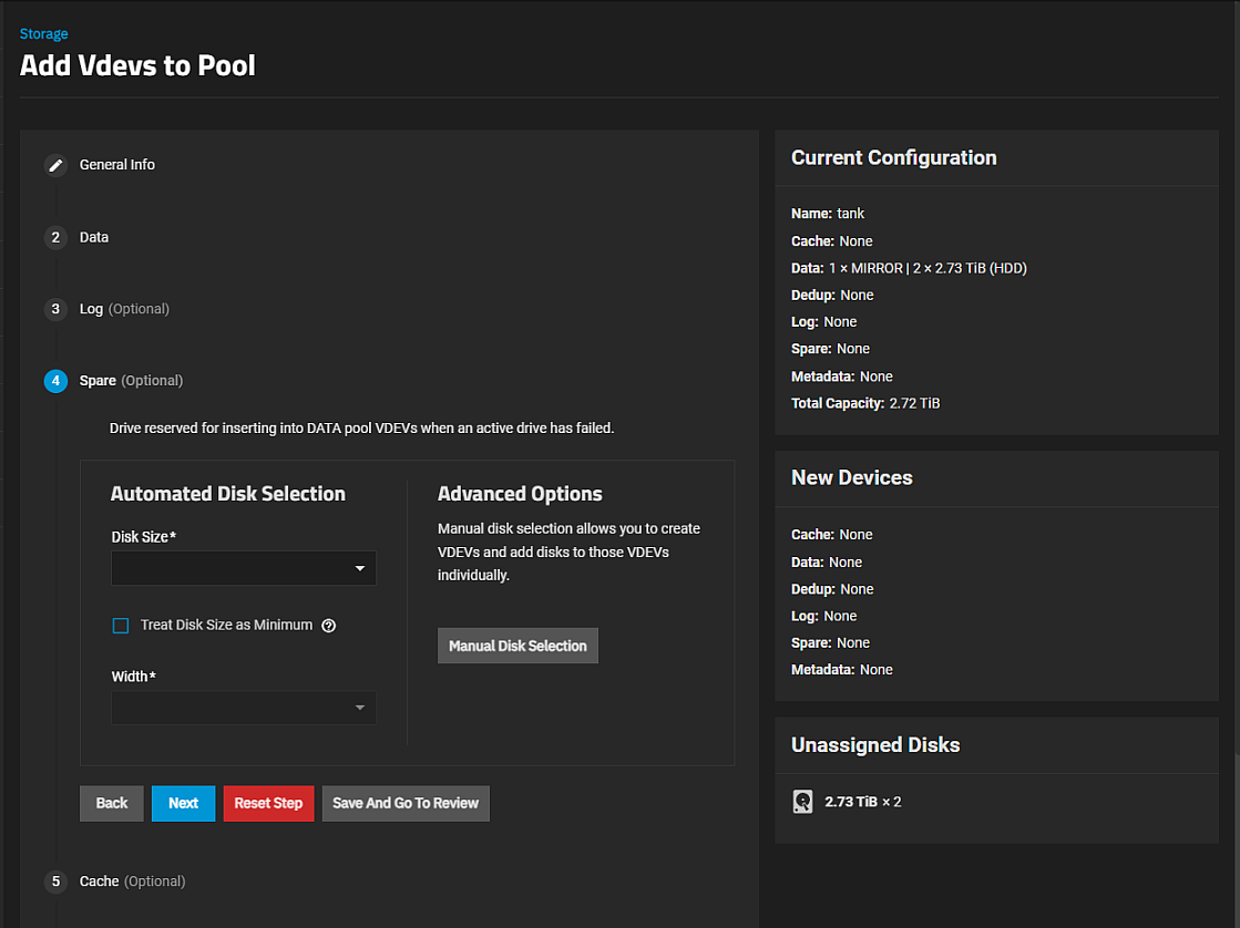

Click Add VDEV to open the Add Vdevs to Pool screen.
Click the Spare (Optional) row to expand it.
Add Vdev Spare
Figure 8: Add Vdev Spare
Select a disk size equal to or greater than the failed disk or click Manual Disk Selection to choose the replacement disk. Click Save And Go To Review.

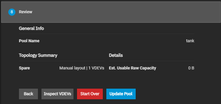

Review changes, then click Update Pool. Select Confirm, then click Continue.
After completing the job, TrueNAS returns to the Storage Dashboard screen. Review Spare VDEVs on the VDEVs widget to confirm the hot spare is added.
