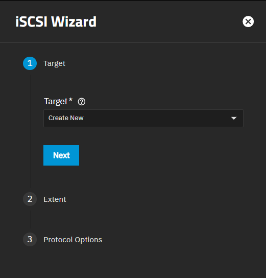

Go to Shares, then click Wizard on the iSCSI Block Share Targets widget.
  1. Click Create New on the Target screen, then click Next or on Extent to go to next screen.
iSCSI Wizard Target Screen
Figure 1: iSCSI Wizard Target Screen

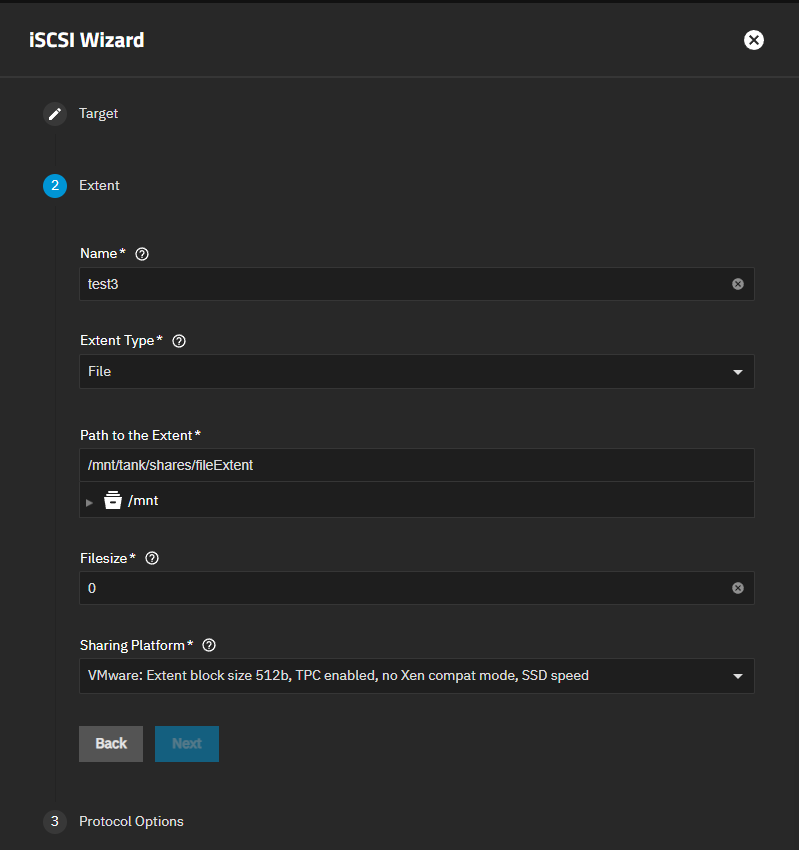

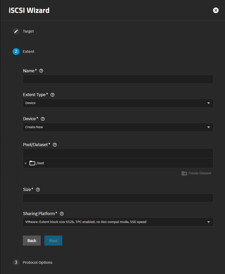

  1. Add the extent and select the device type.
    a. Enter a name using up to 64 lowercase alphanumeric and/or special characters. Allowed characters are dot (.), dash (-), and colon (:). A name longer than 64 characters is not allowed.
    b. Select the extent type. Choose between device and file based on your use case. The screen shows different settings based on the choice.
    If using a zvol, select Device in Extent Type. You can create a new zvol or select an existing zvol as the Device.
    Adding a New Device
    To create a new zvol, set Device to Create New.
    Browse to select the path to the parent dataset using the file browser field below Pool/Dataset. Selecting the parent dataset activates Create Dataset.
    Click Create Dataset, enter a name that does not exceed 64 lowercase alphanumeric and/or special characters, then click Create. The mount path under Pool/Dataset populates with the path to the new zvol.
    To use an existing zvol, after selecting Device in Extent Type, select Existing, then browse to select the existing zvol.
    Enter a numerical value and suffix to specify the size of the zvol you are creating in Size.
    Adding a File
    To use a file for the extent, select File in Extent Type.
    Enter or browse to select the mount point to the directory you want to use. If a directory does not exist, after selecting the parent dataset where you want to add the directory, enter a / followed by the name to add the directory to the dataset.
    Enter the size for the directory in Filesize. Leave this set to 0 to use the actual file size. This requires that the file already exists. Otherwise, specify the file size for the new file.
    c. Select the sharing platform, then click Next or on Protocol Options to advance to the next step.

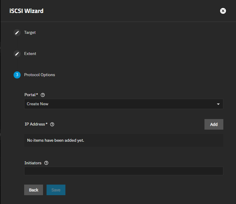

  2. Create a portal or select an available existing portal.
    Select a portal from the dropdown list or click Create New to add a new portal. If you create a new portal, click Add to enter an IP address and netmask (CIDR) for the portal. To add another, click Add again.
    Leave Initiator blank to allow all, or enter a host name to limit access to the select client. To enter more than one host name, press Enter after each to separate each entry. You can edit initiators from the individual screens on the iSCSI screen after adding the target.
  3. click Save.

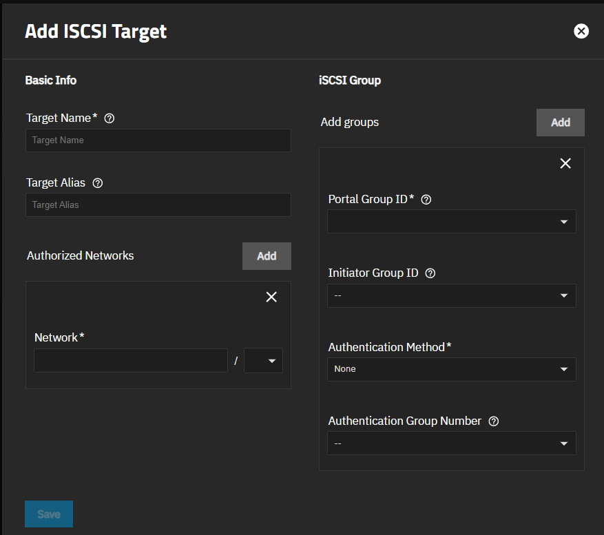

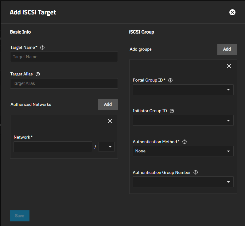

  1. Add a target.
    a. Click Add to open the Add iSCSI Target screen.
    b. Enter a name using lowercase alphanumeric characters plus dot (.), dash (-), and colon (:) in Target Name. Use the iqn.format for the name. See the “Constructing iSCSI names using the iqn.format” section of RFC3721.
    You can enter a common name for the target in Target Alias, but this is not required.
    c. (Optional) Add authorized networks. Click Add to show the Network fields to enter a publicly accessible IP address and netmask (CIDR). This allows communication between client computers and the iSCSI target. Click Add for each address you want to add. Addresses are added to the iSCSI Authorized Networks widget.
    d. (Optional) Click Add to the right of Add Groups to enter portal settings. You can add a portal from the Portals screen. Click on the Portals tab, then click Add to open the Add iSCSI Portal screen.
    Select a target with a number assignment from the dropdown list in Portal ID.
    Select a group from the Initiator Group ID. You can add initiator groups (client groups) from the Initiators screen. Click on the Initiators tab, then click Add to open the Add iSCSI Initiator screen.
    Select the authentication method from the dropdown list. None allows anonymous discovery. CHAP uses one-way authentication. Mutual CHAP uses two-way authentication. To show the Mutual CHAP option, you must set the peer user and secret password. For more information on authentication methods, see iSCSI Screens.
    The Authentication Group Number dropdown list populates after configuration groups on the Add Authorized Access screen. Edit the target after adding these groups if you want to include them.
    e. Click Save.

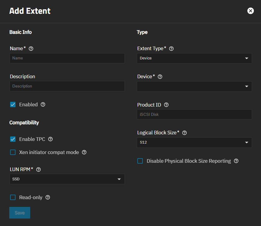

  2. Add extent(s). Click on the Extents tab, then click Add to open the Add iSCSI Extent screen.
    a. Enter a name.
    b. Add a description about the extent if you want, but this is not required. The description shows in the Target table on the Targets screen and the iSCSI Block Share Targets widget and helps identify the share use or purpose.
    c. Select Enabled to enable the extent.
    d. Leave Enable TCP selected. To disable it, clear the checkbox. Select Xen initiator compat mode if required for your share.
    e. Set the device type as Device or File.
    Adding a Device Extent
      After choosing **Device** in **Extent Type**, select the zvol or zvol snapshot from the **Device** dropdown list. The zvol must already exist to add it here.
      Accept the default in **Logical Block Size** or change the size to what fits your use case.

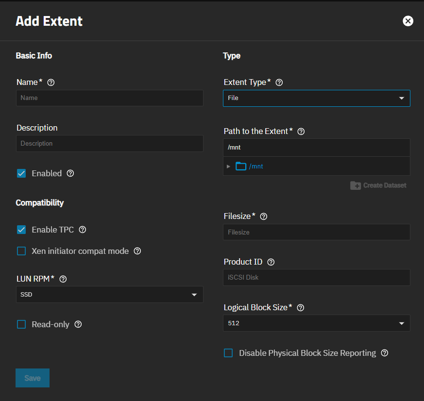

    Adding a File Extent
      After choosing **File** in **Extent Type**, enter or browse to select the path to an existing file.
      Enter a slash (/) followed by a file name to create a file in a dataset and append the file name to the path (/filename.ext).
      Enter the file size. Enter **0** to use the actual file size of an existing file, or specify the size to apply to the new file added in **Path to the Extent**.

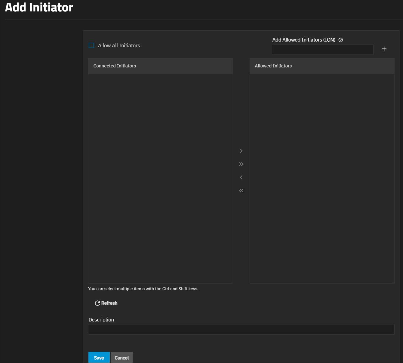

  3. Add initiator groups. Click on the Initiators tab, then click Add to open the Add Initiator screen.
    Leave Allow All Initiators selected, or clear and enter the host names or IP addresses of the ISNS servers to register with the iSCSI targets and portals of the system. Separate entries by pressing Enter.
    Click Save.

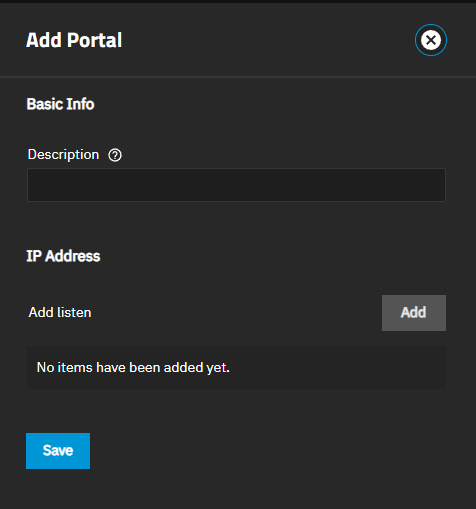

  4. Add portals. Click on the Portals tab, then click Add to open the Add Portal screen.
    a. Enter a description for the portal if desired.
    b. Click Add to show the IP Address field. Enter the IP address and netmask (CIDR) for the portal. Click Add for each IP address to add.
    Enter 0.0.0.0 to listen on all IPv4 addresses, :: to listen on all IPv6 addresses, or enter the server IP address.
    c. Click Save.

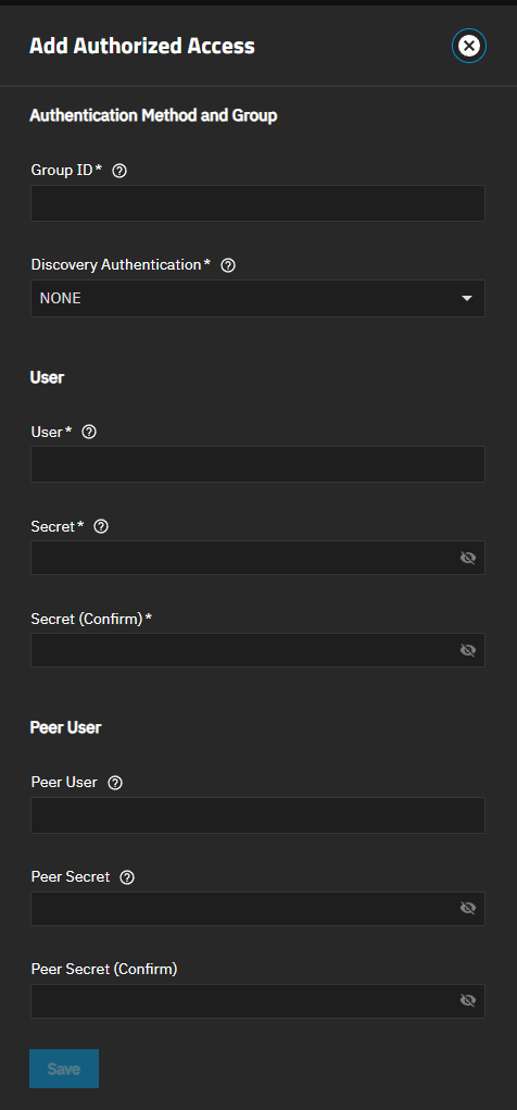

  5. Enter authorized access networks. Click on the Authorized Access tab, then click Add to open the Add Authorized Access screen.
    a. Enter a number in Group ID. This field configures different groups with different authentication profiles. For example, all users with a group ID of 1 inherit the authentication profile associated with Group 1.
    b. Select the discovery method from the dropdown list. None allows anonymous discovery. CHAP uses one-way discovery. Mutual CHAP uses two-way discovery, but not show as an option until you add the Peer User and Peer Secret credentials.
    c. Enter a username and password for CHAP authentication to the remote system. These can be the admin user account credentials.
    d. Enter a peer user account and password if using Mutual CHAP authentication. The Peer Secret cannot be the same password entered in Secret. You can select Mutual CHAP as the discovery method now.
    e. Click Save.

  1. Click Add to open the Add iSCSI Target screen.
  2. Enter a name in Target Name. Use lowercase alphanumeric characters plus dot (.), dash (-), and colon (:) in the iqn.format. See the “Constructing iSCSI names using the iqn.format” section of RFC3721.
  3. (Optional) Enter a user-friendly name in Target Alias.
  4. Add authorized networks. Click Add to show the Network fields where you can enter an IP address and netmask (CIDR). This allows communication between client computers and the iSCSI target. Click Add for each address you want to add. Addresses are added to the authorized networks list.
  5. Click Add to the right of Add Groups to enter portal settings. Portal and group settings can be added later or on the Add Portal screen, and initiator groups can be added by editing the target or using the Add Initiators screen.
    Select the authentication method from the dropdown list. None allows anonymous discovery. CHAP uses one-way authentication. Mutual CHAP uses two-way authentication. For more information on authentication methods, see iSCSI Screens.
    Select a portal ID from the Initiator Group ID dropdown list.
    The Authentication Group Number dropdown list is populated after configuration groups on the Add Authorized Access screen. Edit the target after adding these groups if you want to include them.
  6. Click Save.
